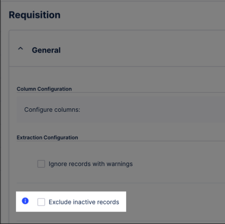

You can enable the exclusion of inactive records when extracting data from SAP Ariba. If enabled, the platform passes the parameter 'includeInactive=false' in all extraction requests, alerting SAP Ariba to exclude any inactive records on a table level.
The option is available for all asynchronous APIs of Ariba (Procurement, Sourcing, Analytical Reporting). We recommend activating this option in specific cases where the SAP Ariba Extractions failed due to the data present in the inactive records.
To enable this for your asynchronous SAP Ariba extractions, click Data Jobs - Table Configuration and select Exclude inactive records:
