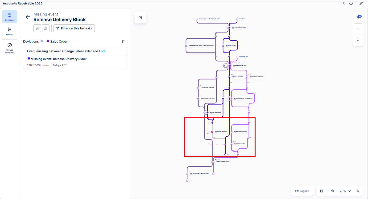

  4. Select any deviation to view more details about that deviation.
    The dashed line shows where the deviation occurs. Here, the deviation is a missing event.

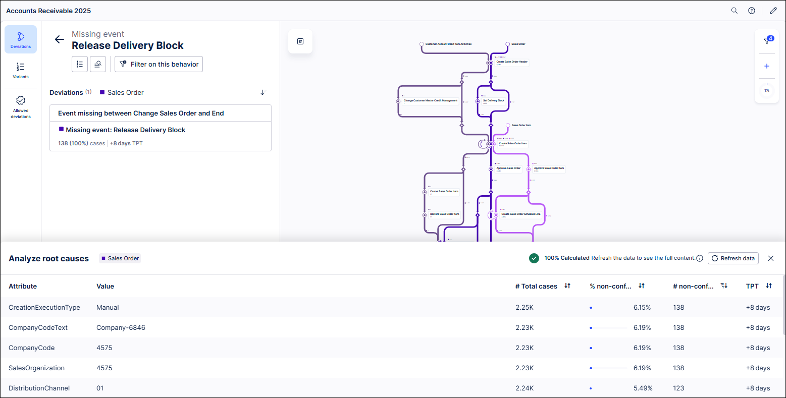

  5. Select analyze_root_causes_button.png to analyze the root causes of the deviation.
    A table that displays detailed information about the selected deviation appears. You may need to select Refresh data to ensure all data is displayed.
  6. Explore the variants associated with specific deviations and perform an end-to-end analysis.
