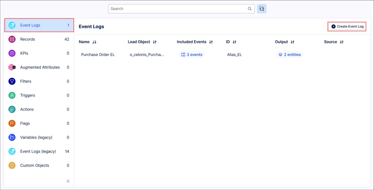

To create case-centric event logs in your KM:
  1. Click Studio and then open the package containing the KM you want to create the event log in.
  2. Open the KM asset.
  3. Click Event Logs and select Create Event Log.
  4. Configure your event log using the following settings:

    A screenshot showing the event log configuration screen.
  5. Use the preview to check if your event log is working as desired. If not, re-configure your event log and try again.
  6. Click Save.
    The event log is added to your KM and can be used in the process explorer.
