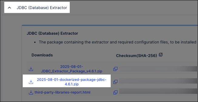

  2. In the Celonis Platform, click Admin & Settings > Download Portal, and download the latest JDBC (Database) Extractor zip file:
