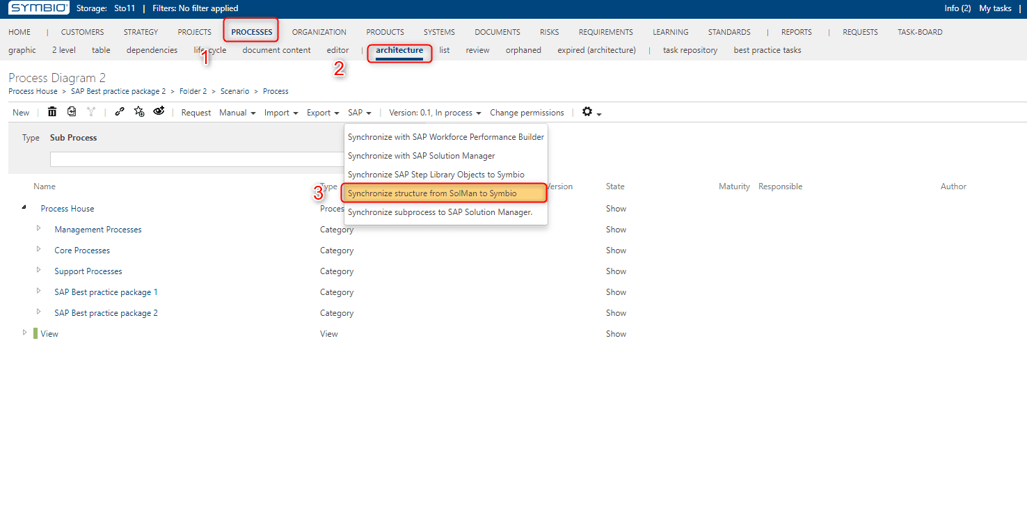

To synchronize the structure from SAP Solution Manage to Celonis Process Management go to Processes > architectureand click theSAP button. Then click Synchronize best practice package.

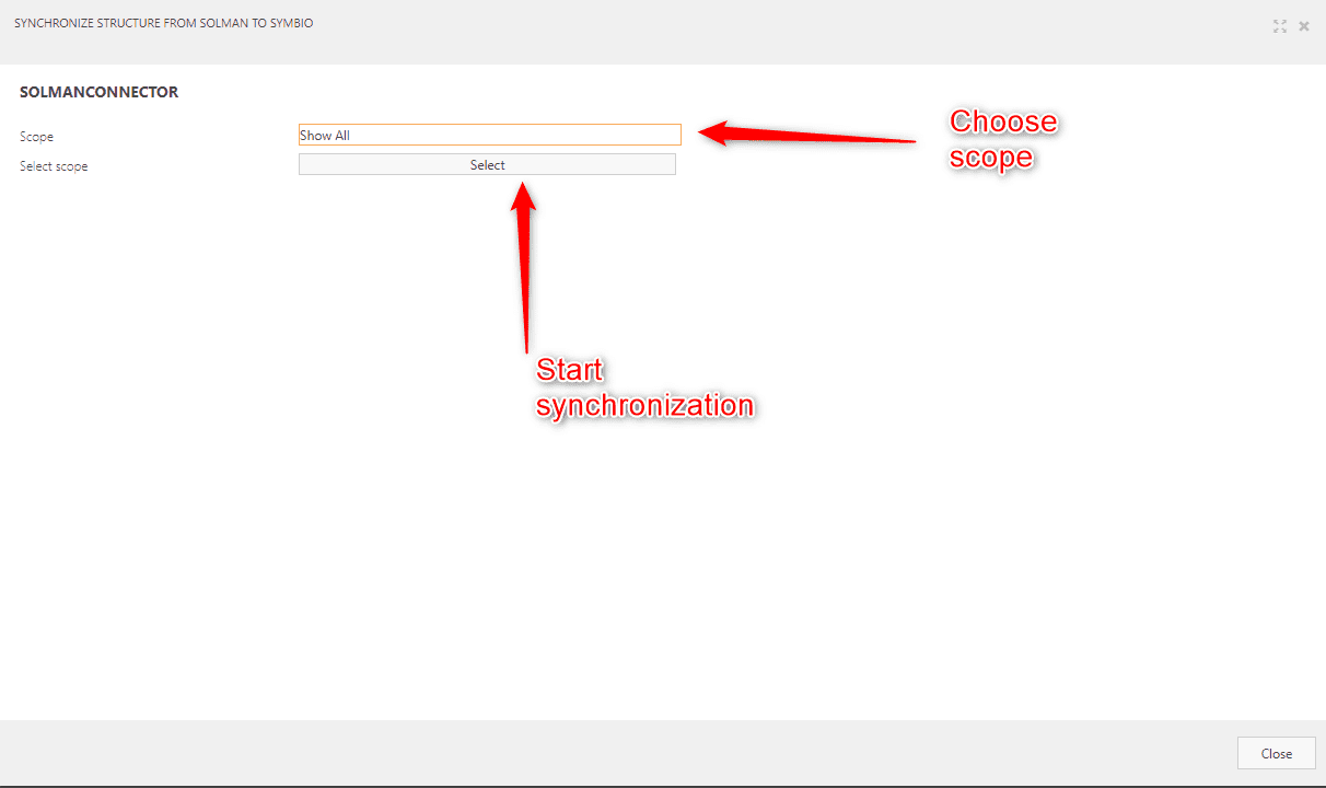

A dialog will open. Choose what scope you want to sync, or if you leave it empty, the entire structure will be synced.

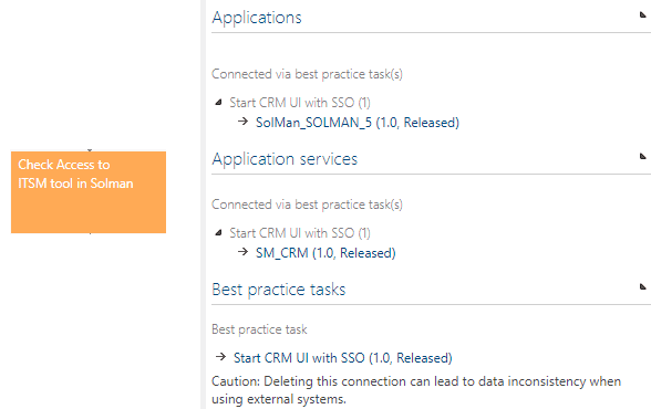

When the synchronization is done there will be a new category added to the process house element. The entire synchronized structure will be in this category. The elements will be released and not editable. For now you can copy only diagram elements to another structure.
If a synchronized Task has an attached Best Practice Task, the Application and Application service that are attached to that Best Practice Task are also visible in the detail content of the Task:
