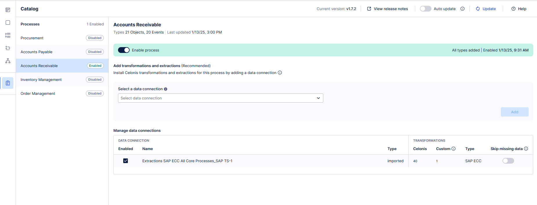

Enable and configure the Accounts Receivable process for SAP from the Celonis catalog.

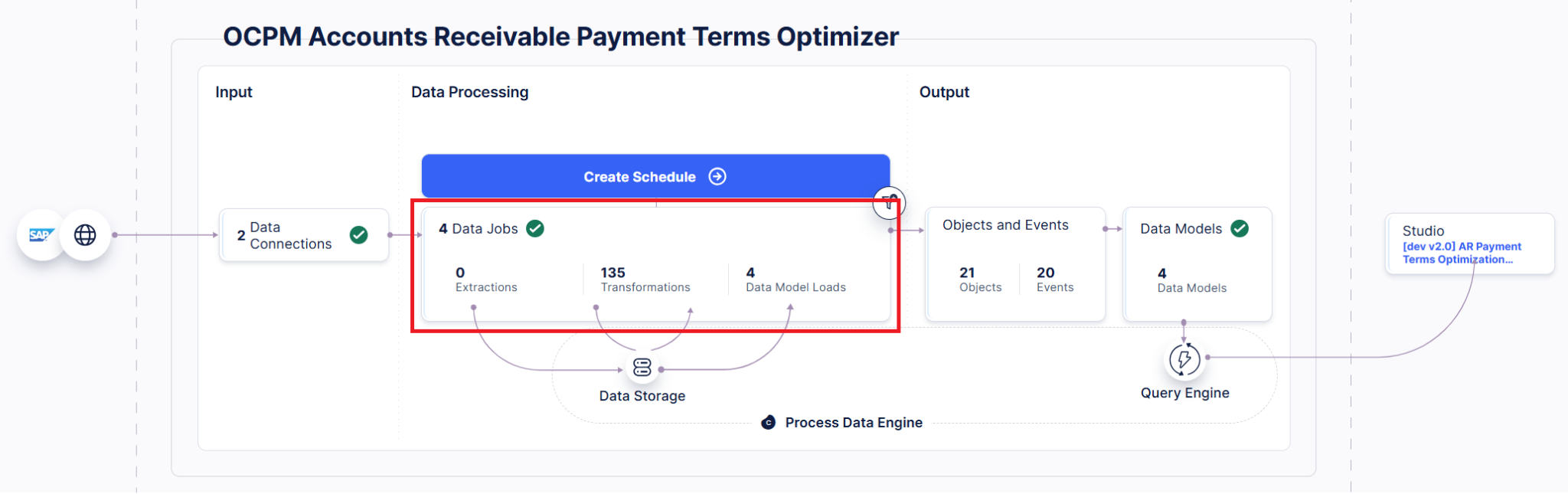

Here’s how to set up the app-specific items. If you want to replace the manual procedure with the automated Module for Advanced Deployments, run the module now. Afterwards, check through the manual procedure and make sure everything described in it is now available in your object-centric data model and data pool.

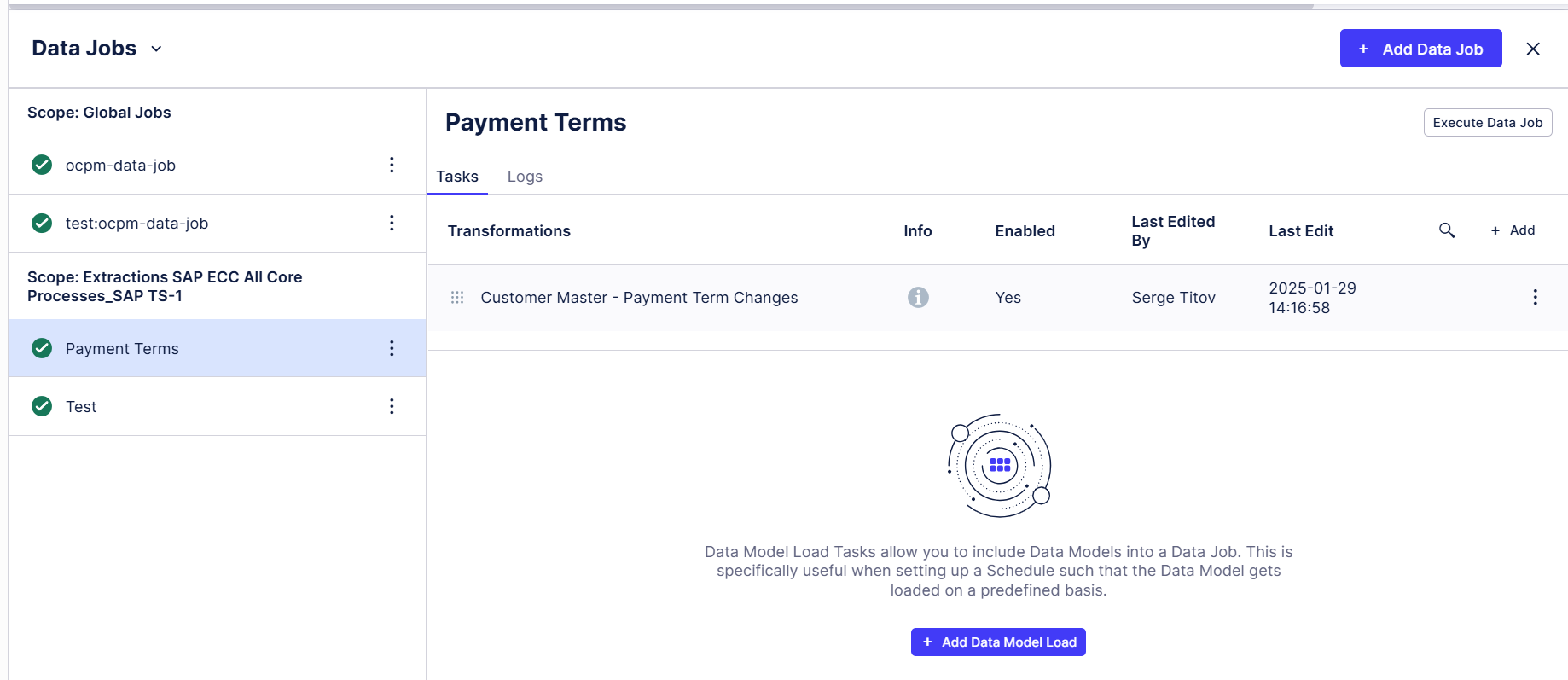

From the Celonis navigation bar, select Data > Data Integration, then select the data pool where you’re working with objects and events. Select Data Jobs in the data pool.
Select each data job in each scope, and add to each the transformation “Customer Master - Payment Term Changes”.
--- Step 1: Get all change log for KNVV ZTERM DROP TABLE IF EXISTS TMP_PT_MD_CHANGES_KNVV; CREATE TABLE TMP_PT_MD_CHANGES_KNVV AS ( SELECT "CDPOS"."MANDANT" ,"CDPOS"."FNAME" ,"CDPOS"."TABNAME" ,"CDPOS"."TABKEY" ,"CDPOS"."VALUE_OLD" ,"CDPOS"."VALUE_NEW" ,CAST("CDHDR"."UDATE" AS DATE) + CAST("CDHDR"."UTIME" AS TIME) AS "EVENTTIME" ,"CDHDR"."CHANGENR" ,"CDHDR"."TCODE" ,"CDPOS"."OBJECTCLAS" ,"CDPOS"."OBJECTID" ,"CDHDR"."USERNAME" FROM "CDHDR" CDHDR INNER JOIN CDPOS CDPOS ON 1=1 AND "CDPOS"."MANDANT" = "CDHDR"."MANDANT" AND "CDPOS"."OBJECTCLAS" = "CDHDR"."OBJECTCLAS" AND "CDPOS"."OBJECTID" = "CDHDR"."OBJECTID" AND "CDPOS"."CHANGENR" = "CDHDR"."CHANGENR" AND "CDPOS"."CHNGIND" = 'U' AND "CDHDR"."UDATE" IS NOT NULL AND "CDPOS"."FNAME" IN ('ZTERM') AND "CDPOS"."TABNAME" IN ('KNVV') ); --- Step 2: Get all change logs for KNVV ZTERM DROP TABLE IF EXISTS MD_PT_CHANGES_KNVV; CREATE TABLE MD_PT_CHANGES_KNVV AS ( --- Get Zterm periods for KNVV ZTERM SELECT --- Historic changes TABKEY, FNAME, VALUE_OLD "ZTERM", COALESCE(LAG(EVENTTIME) OVER (PARTITION BY TABKEY ORDER BY EVENTTIME),'1953-01-01 00:00:00') "FROM_TIME" ,EVENTTIME "TO_TIME", CHANGENR FROM TMP_PT_MD_CHANGES_KNVV UNION --- Pot. drop duplicates for the latest change SELECT --- Get Latest change TABKEY,FNAME,VALUE_NEW "ZTERM",EVENTTIME "FROM_TIME",NOW() + INTERVAL '1 year' "TO_TIME",'9999999999' "CHANGENR" --- Adding 1 year to ensure it works FROM ( SELECT * FROM ( SELECT *,ROW_NUMBER() OVER (PARTITION BY TABKEY ORDER BY EVENTTIME DESC) RN FROM TMP_PT_MD_CHANGES_KNVV ORDER BY EVENTTIME ) TMP_PT_MD_CHANGES_KNVV_ORDERED WHERE RN =1 ) TMP_PT_MD_CHANGES_KNVV_LATEST ); --SELECT * FROM MD_PT_CHANGES_KNVV --- Step 3: Get all change log for KNB1 ZTERM DROP TABLE IF EXISTS TMP_PT_MD_CHANGES_KNB1; CREATE TABLE "TMP_PT_MD_CHANGES_KNB1" AS ( SELECT "CDPOS"."MANDANT" ,"CDPOS"."FNAME" ,"CDPOS"."TABNAME" ,"CDPOS"."TABKEY" ,"CDPOS"."VALUE_OLD" ,"CDPOS"."VALUE_NEW" ,CAST("CDHDR"."UDATE" AS DATE) + CAST("CDHDR"."UTIME" AS TIME) AS "EVENTTIME" ,"CDHDR"."CHANGENR" ,"CDHDR"."TCODE" ,"CDPOS"."OBJECTCLAS" ,"CDPOS"."OBJECTID" ,"CDHDR"."USERNAME" FROM "CDHDR" CDHDR INNER JOIN CDPOS CDPOS ON 1=1 AND "CDPOS"."MANDANT" = "CDHDR"."MANDANT" AND "CDPOS"."OBJECTCLAS" = "CDHDR"."OBJECTCLAS" AND "CDPOS"."OBJECTID" = "CDHDR"."OBJECTID" AND "CDPOS"."CHANGENR" = "CDHDR"."CHANGENR" AND "CDPOS"."CHNGIND" = 'U' --AND "CDPOS"."VALUE_OLD" IS NOT NULL AND "CDHDR"."UDATE" IS NOT NULL AND "CDPOS"."FNAME" IN ('ZTERM') AND "CDPOS"."TABNAME" IN ('KNB1') ); --- Step 4: Get all change logs for KNB1 ZTERM DROP TABLE IF EXISTS MD_PT_CHANGES_KNB1; CREATE TABLE MD_PT_CHANGES_KNB1 AS ( --- Get Zterm periods for KNB1 ZTERM SELECT --- Historic changes TABKEY, FNAME, VALUE_OLD "ZTERM", COALESCE(LAG(EVENTTIME) OVER (PARTITION BY TABKEY ORDER BY EVENTTIME),'1953-01-01 00:00:00') "FROM_TIME" ,EVENTTIME "TO_TIME", CHANGENR FROM TMP_PT_MD_CHANGES_KNB1 UNION --- Pot. drop duplicates for the latest change SELECT --- Get Latest change TABKEY,FNAME,VALUE_NEW "ZTERM",EVENTTIME "FROM_TIME",NOW() + INTERVAL '1 year' "TO_TIME",'9999999999' "CHANGENR" --- Adding 1 year to ensure it works FROM ( SELECT * FROM ( SELECT *,ROW_NUMBER() OVER (PARTITION BY TABKEY ORDER BY EVENTTIME DESC) RN FROM TMP_PT_MD_CHANGES_KNB1 ORDER BY EVENTTIME ) TMP_PT_MD_CHANGES_KNB1_ORDERED WHERE RN =1 ) TMP_PT_MD_CHANGES_KNB1_LATEST )From the Celonis navigation bar, select Data > Objects and Events, then select Objects in the top navigation bar.

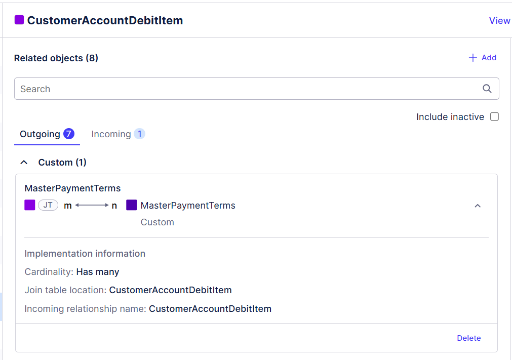

Create an object to object relationship between the new custom object type MasterPaymentTerms and the Celonis object type CustomerAccountDebitItem. Here’s how:
In the pane for the Celonis object type CustomerAccountDebitItem, select Relationships to objects.
Click Add, and add an outgoing relationship to the custom object type MasterPaymentTerms. Make this a many to many (m:n) relationship. Use the suggested name for the relationship.
Click Save to create the object to object relationship.

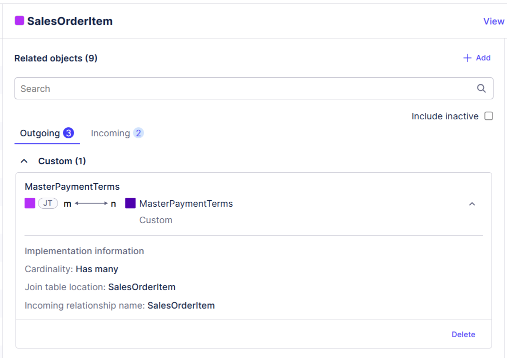

Create an object to object relationship between the new custom object type MasterPaymentTerms and the Celonis object type SalesOrderItem. Here’s how:
In the pane for the Celonis object type SalesOrderItem, select Relationships to objects.

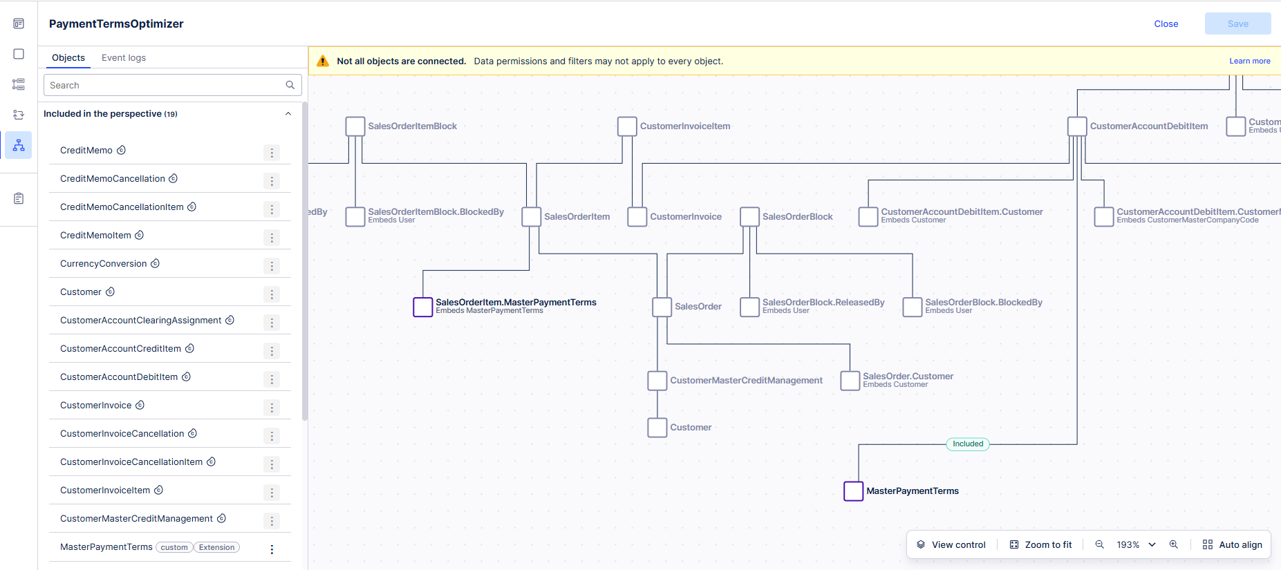

Extend the Celonis catalog perspective for the Accounts Receivable process to add the MasterPaymentTerms object. You’ll add it twice, once as a linked object and once as an embedded object. The perspective already contains the other objects, so their new attributes will be added automatically. Here’s how to extend the perspective:
Go back to the Objects and Events environment, and select Perspectives in the top navigation bar. Find the Celonis-supplied Accounts Receivable perspective (perspective_celonis_AccountsReceivable).
Click the Extend button, or go to the context menu (the three vertical dots) for the perspective and select Extend.
Type a name for the extension - we recommend “PaymentTermsOptimizer” - and click Next.
Search in the Object list for the custom object type MasterPaymentTerms. Select it to see its details pane.
Select Linked objects in the sidebar.
Click Add and start typing the name of the CustomerAccountDebitItem object type, then click to select it.
Select the checkbox button for the MasterPaymentTerms relationship between the two object types.
Now search in the Object list for the Celonis object type SalesOrderItem. Select it to see its details pane.
Select Embedded objects in the sidebar.
Click Add and start typing the name of the MasterPaymentTerms object type, then click to select it.
Select the radio button for the MasterPaymentTerms relationship between the two object types.
Click Save to save the extension.
