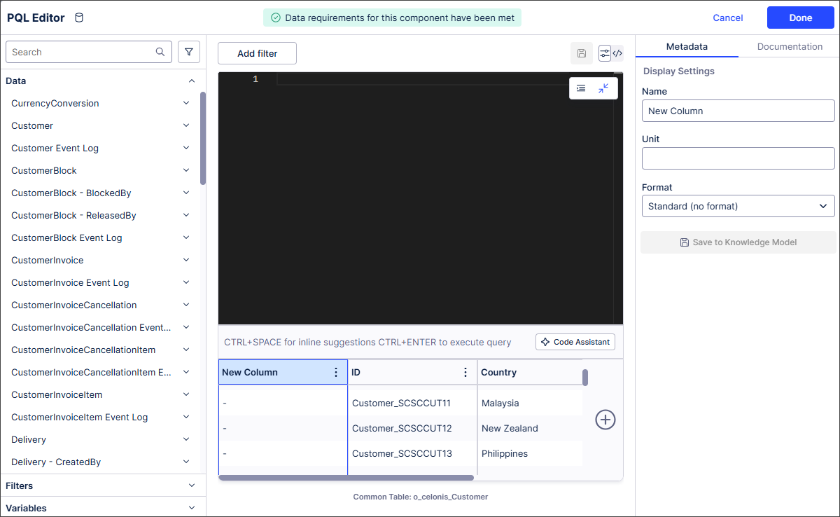

The PQL editor enables you to translate process-related business questions into queries, which are then executed by a custom-built query engine. This editor can now be accessed directly from your View layout builder, helping you create detailed Views with your data. Filtering in the PQL editor is consistent with filtering in Views.
Screenshot showing the PQL editor user interface

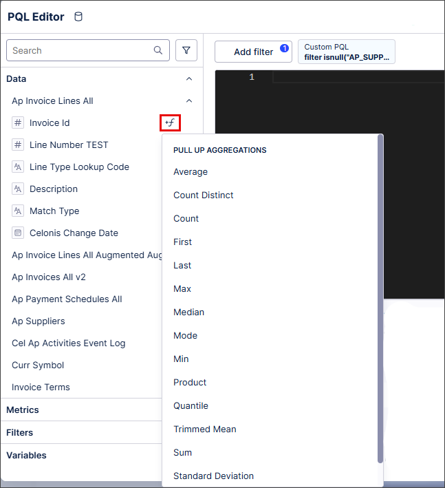

The data and variables displayed in the PQL editor are imported from Knowledge Models and package variables within the same package. They can be added to the PQL editor using the + icon or you can use the the +f button to apply aggregate functions to the data added.
Aggregate functions include Count distinct, Median, Min, Max and Sum.
Screenshot displaying the aggregation functions available for a specific data attribute.

You can now execute PQL queries and see the live results within the table whenever changes are made.
Click Run PQL when prompted or use the keyboard shortcut CTRL + ENTER.
After executing the query, either the table will update with the results or you will be shown a PQL error message with further information.
