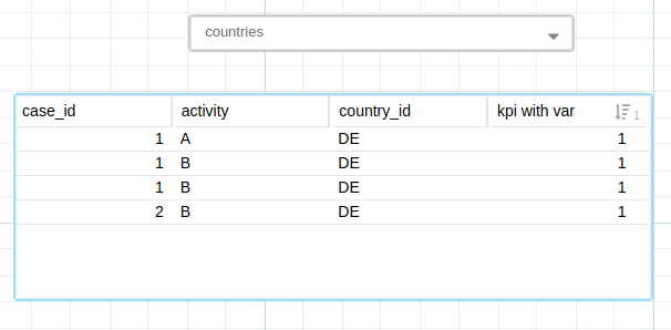

What is important to understand is that whatever components you use to design a dashboard - all of them will translate into one or multiple PQL queries. Depending on the complexity, they can take more or less time to execute. Simple front-end components and the corresponding query:
FILTER KPI ("kpi_formula", VARIABLE('DE')) = 1TABLE( "activities"."case_id" AS "case_id", "activities"."activity" AS "activity", "activities"."country_id" AS "country_id", KPI("kpi_formula", VARIABLE ('DE')) AS "kpi with var" ) ORDER BY KPI("kpi_formula", VARIABLE ('DE')) DESC LIMIT 400;Designing performant Views and Boards

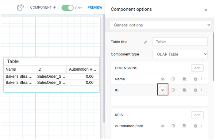

Additional tips that could help improve your dashboard's performance:

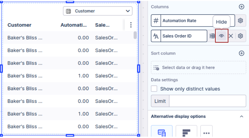

Hide columns by default and only show them when needed. This lets you concentrate on the necessary information and also improves the performance of your dashboards. This is where you can find these options in Analysis and Views:
Analysis (under General Options)
View (under Settings > Columns)

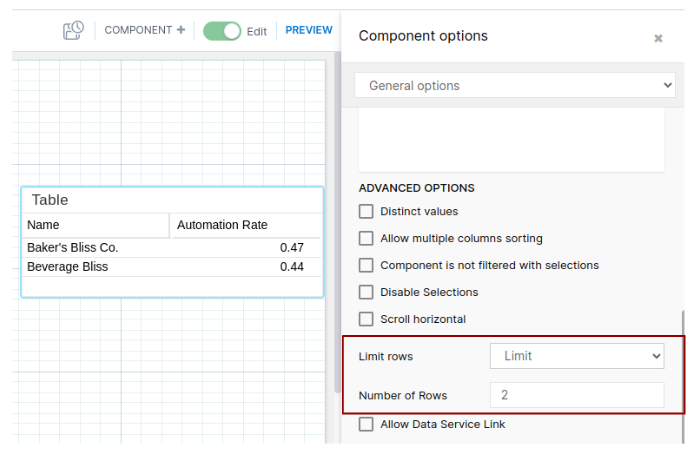

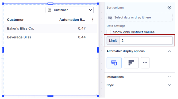

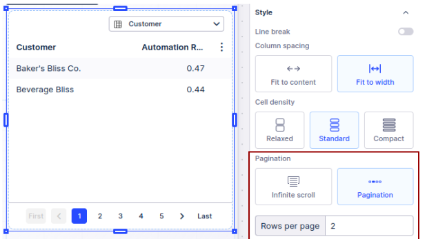

When you have large columns that you want to analyze - try not to visualize columns in their entirety in your dashboard. Instead, try using the "limit" option to show only a specific number of rows. Another option to use is "scrolling" (the alternative option in Analysis after "limit") or "pagination" (in Views) - this way you will be able to view your data by scrolling or clicking through pages. When you enable these options, your data gets loaded in smaller batches making your front-end experience smoother. This is where you can find these options in Analysis and Views:
Analysis (under Advanced Options)
View limit (under Settings > Data settings)
View pagination (under Settings > Style > Pagination)

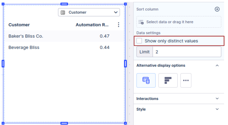

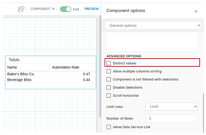

Avoid using the distinct values option when not absolutely necessary. Remember that the rows are often already distinct, especially so when the number of columns is high. This is where you can find the "distinct values" option in Analysis and Views:
View (under Settings > Data settings)

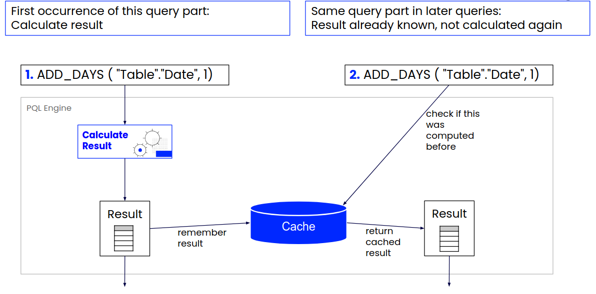

Understanding caching
What is caching
To make queries execute faster we use caching. A cache is a temporary storage. Caching is the process of storing the result of a query (or parts of the query) in cache so that the same query can be answered in the future without being executed again. The result is then just recalled from the cache.
Note: Loading results from cache may not always be instantaneous. In order to make the best usage of the limited cached capacity, cached columns that are not accessed for 5 minutes are compressed to preserve space. In addition, if they are not accessed for 30 minutes they get moved from the in-memory cache to disk. This means that you might experience a delay when accessing cached results that have not been used for a while, because they have to be decompressed or even read from disk before they can be used again.
Cache warmup
Cache warmup happens at the end of the data model load whenever new data is loaded. The aim of cache warmup is to offer the fastest possible query runtime. What this means is that we gather the statistics about the most computationally-intensive queries and we execute those queries right after the data model load. The results are then stored in cache and can be recalled anytime, which offers a smooth front-end experience.
Note: The data model load will not be shown as complete until the cache warmup is finished as well. This can be very important if you have frequent data model loads. In that case it makes sense to think about the tradeoff between the time needed to finish the data model load and to run the queries afterwards. Longer query warmup will in most cases make the query execution more efficient, but it is not a "one-size-fits-all" and it might not make sense for every single data model.

Writing cache efficient queries
When exactly do the results of your query get cached? When the computation of the result does not depend on the current filter state.
Some functions take filters into account and others do not.
Standard aggregation (for example, AVG) take filters and selections into account. Values that are filtered out are not a part of the result. That means that the results of standard aggregations are not cached.
On the other hand, PU-functions (for example, PU_AVG) ignore filters. This means that if the filter changes, the result of a PU function will not be affected and also will not be recalculated - the result of a PU-function can be cached. Very important to note here is that caching PU-functions becomes impossible once you decide to use another operator inside the PU function which takes filters into account. This table shows some examples of queries which are cached and some which are not cached. The last example shows the previously mentioned example when the cacheability stops because of FILTER_TO_NULL used inside the function.
Query | Cached? | Reason |
"Table"."Price" + "Table"."Tax" | cached | Filter independent operator, so it gets cached. |
CASE WHEN "Table"."Type" = 'T1' THEN 1 ELSE NULL END | cached | If CASE WHEN statements are filter-independent, then the result of CASE WHEN will also be cached. |
AVG("Table"."Price") | not cached | Standard aggregations take filters into account, so the result will not be cached here. |
PU_AVG("TargetTable", "Table"."Value") | cached | PU-functions do not take filters into account, so this will be cached. |
PU_AVG("TargetTable", FILTER_TO_NULL("Table"."Value")) | not cached | FILTER_TO_NULL makes PU functions filter-dependent, so this will not be cached. |

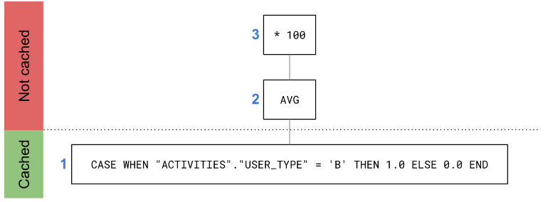

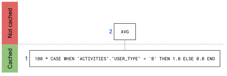

For complex expressions composed of filter-dependent and filter-independent operators, only sub expressions that do not contain a filter-dependent operator will be cached.
Consider the following expressions:
100 * AVG (CASE WHEN "ACTIVITIES"."USER_TYPE" = 'B' THEN 1.0 ELSE 0.0 END)
CASE WHEN is filter independent and will be cached. However, AVG cannot be cached and therefore the surrounding multiplication cannot be cached:
A rule of thumb here is to avoid computations on the result of a non-cached operator whenever possible. In this case, we can get the same result by performing the multiplication before the AVG:

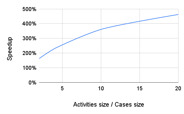

Using PU-functions effectively
As mentioned before, PU-functions are mostly cached. Additionally, they can be nested into other aggregations or other PU-functions. This gives better query performance. Take a look at the example below.

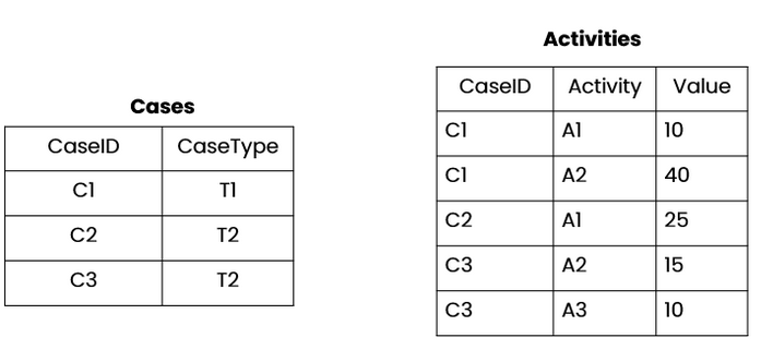

If we want to calculate a maximum of all activities per CaseType, we could choose one of these options:
Option 1 | Option 2 |
"Cases"."CaseType", MAX("Activites"."Value") | "Cases"."CaseType", MAX(PU_MAX("Cases","Activites"."Value")) |
Option 2 allows you to lower the dimension you are calculating on by first pulling up the values to the table representing cases. The non-cached MAX operator is then only calculated on the "Cases" table, instead of on all of the values in the "Activities" table.
Since activity tables are usually much larger than case tables, this can greatly reduce the runtime of the query. The following graph shows the speedup factor depending on how large the "Activities" table is compared to the "Cases" table:

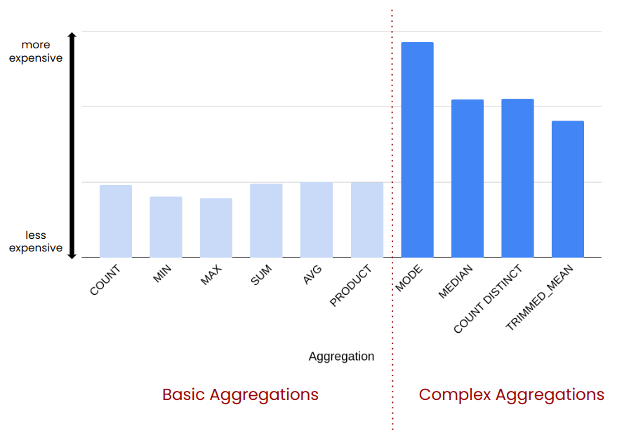

While standard aggregations are sometimes used interchangeably, some are less expensive than others. We can roughly divide aggregations into two categories:
Simple Aggregations | COUNT, MIN, MAX, SUM, AVG, PRODUCT. |
Complex Aggregations | MEDIAN, QUANTILE, MODE, COUNT_DISTINCT, TRIMMED_MEAN. |
Complex aggregations require more steps to be computed and can be quite expensive in comparison. The following graph gives you an idea about how expensive different standard aggregations are:

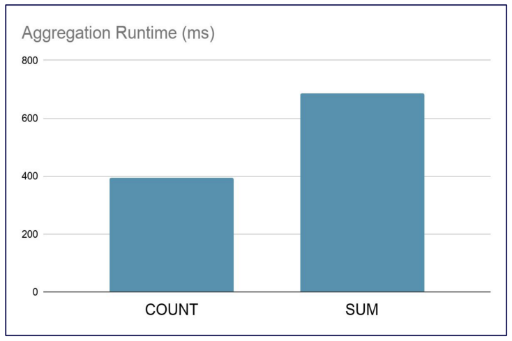

Sometimes the result given by COUNT could be obtained using SUM instead. However, COUNT is less expensive and should be preferred in these situations.
Example:
Query1 | SUM ( CASE WHEN "Table"."Column" = 'A' THEN 1 ELSE 0 END ) |
Query2 | COUNT ( CASE WHEN "Table"."Column" = 'A' THEN 1 ELSE NULL END ) |
Both Query1 and Query2 give the same result, but Query2 is much faster.

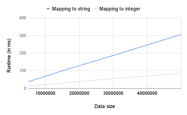

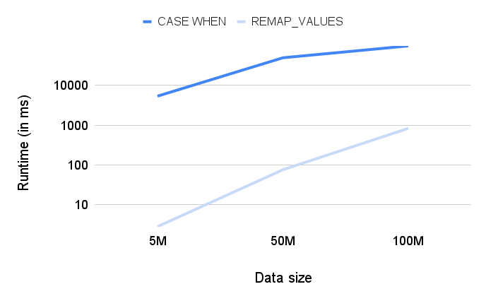

Prefer REMAP_VALUES over CASE WHEN
REMAP_VALUES and CASE WHEN can be used to obtain the same results. However REMAP_VALUES is less expensive than CASE WHEN.
Example:
Query1 | CASE WHEN "Table"."Currency" = 'EUR' THEN 'Euro' WHEN "Table"."Currency" = 'USD' THEN 'US Dollar' ELSE 'Other' END |
Query2 | REMAP_VALUES ( "Table"."Currency", [ 'EUR' , 'Euro' ], [ 'USD', 'US Dollar' ], 'Other' ) |
Both Query1 and Query2 give the same result, but Query2 is faster.

Prefer mapping to INTEGER over mapping to STRING
Sometimes the return type of an expression is not important for the result. For example, this is the case when the goal is to count the number of values in the result. In such situations prefer using INTEGER over STRING since it is a less expensive data type.
Example:
Query1 | COUNT ( DISTINCT CASE WHEN condition THEN string_column ELSE constant END ) |
Query2 | COUNT ( DISTINCT CASE WHEN condition THEN int_column ELSE constant END ) |

COUNT | SUM |

REMAP_VALUES | CASE WHEN |

mapping to integer | mapping to string |

Being aware of expensive operations
Some complex PQL operators perform heavy computations and may require excessive CPU time. Being aware of such operators can help you distinguish the queries where a long runtime is unavoidable from the ones where investigating the query performance and optimizing it could be useful.
The following operators are generally considered expensive:
Note: If the execution time of some of the stated operators exceeds 10 minutes, the execution stops and an error is reported.

Apply aggregations and FILTER_TO_NULL as "late" as possible.
Use less expensive standard aggregations.
