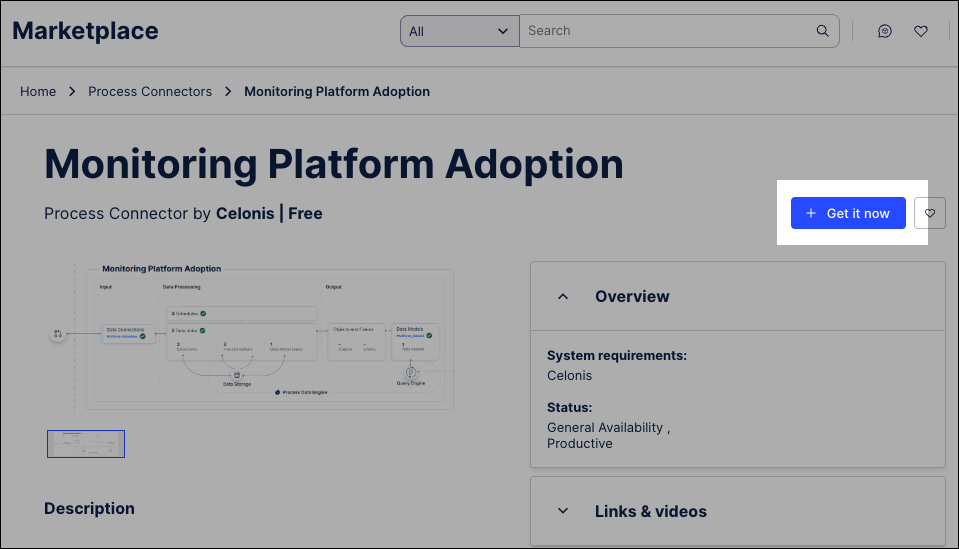

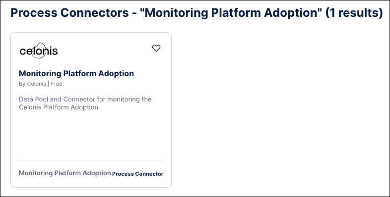

  1. Open the Celonis Marketplace from the Celonis navigation menu, and search for “Monitoring Platform Adoption”. Select the Monitoring Platform Adoption process connector to see its information page.
  2. Select Get it now to install the connector. If you see Request Access instead, click this to request the connector.

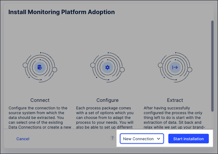

  3. In the installation dialog, select New Connection, then click Start installation.

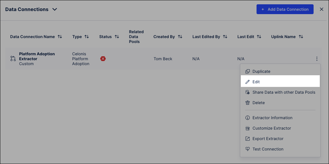

  4. When the connector install is complete, you’ll be in the new data pool Monitoring Platform Adoption that the connector created. In that data pool, select Data Connections. Find the data connection named “Platform Adoption Extractor”, and select Edit from its context menu (the three vertical dots).

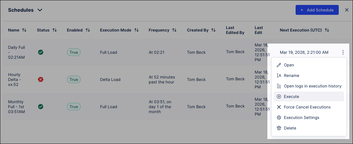

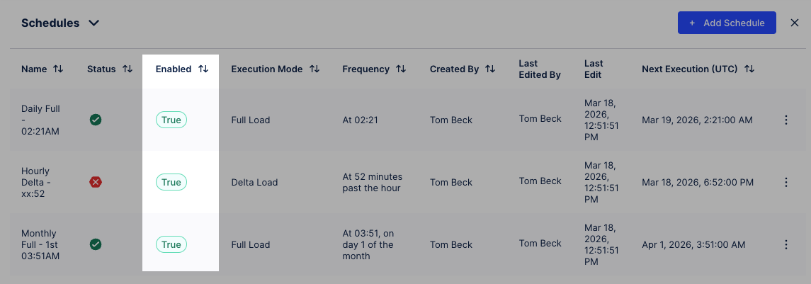

  8. In the Monitoring Platform Adoption data pool, select Schedules. Run the schedule “Daily Full – 02:21AM” to carry out the first data extraction from your Celonis team. To run a schedule, click its context menu (the three vertical dots) and select Execute.
  9. When the data extraction has been completed successfully, run the schedule “Monthly Full – 1st 03:51AM”. Wait for this to also be completed successfully.

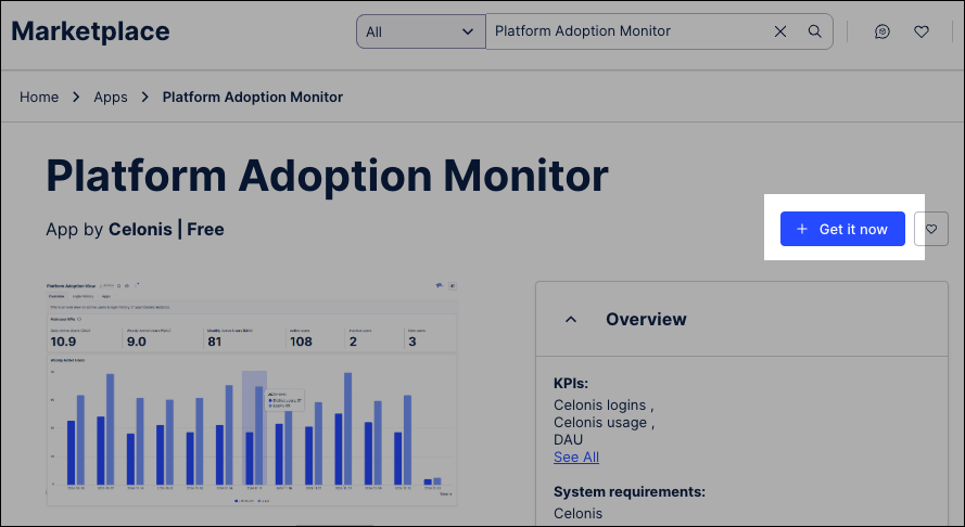

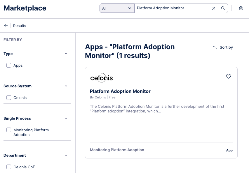

  10. Now install the app. Open the Celonis Marketplace from the Celonis navigation menu, and search for “ Platform Adoption Monitor”. Select the Platform Adoption Monitor app to see its information page.
  11. Select Get it now to install the app. If you see Request Access instead, click this to request the app.
  12. In Celonis, choose a Studio space to install the app in. You can use an existing Studio space, or create a new one, which we suggest you call “Celonis Monitoring”. Click Confirm to proceed with the installation.
