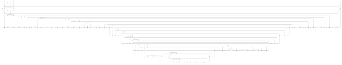

The complexity of models created by the different miner types is shown below. Using the same data, the first example shows a model that was mined using the strict miner type, the second using the balanced miner type. The balanced miner type process graph is significantly less complex.

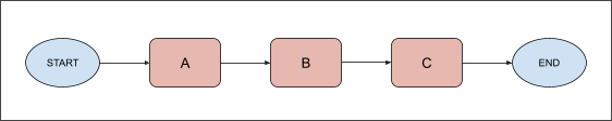

High fitness and high precision model
This model has high fitness since it allows all the behavior seen in the event log and high precision since it does not allow any extra behavior. Perfect fitness and perfect precision mean that the behaviour expressed in the event log is exactly the same as the behaviour allowed by the model.
Image showing a model that is high fitness and high precision.

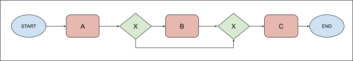

Lower fitness and high precision model
This model does not allow case_id == 2 so it has lower fitness than the high fitness and high precision model but still has high precision as it does not allow any additional behavior.
Image showing a model that is of lower fitness and high precision.

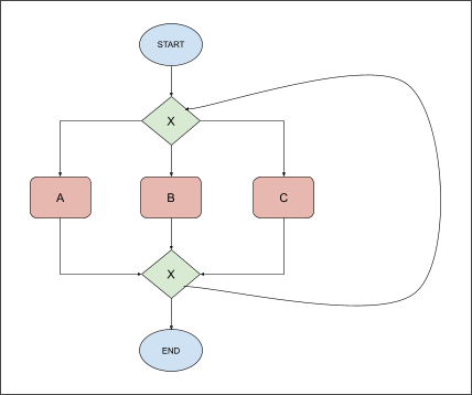

High fitness and very low precision model
This flower model has high fitness, but low precision. The three activities A, B and C can occur in any combination. It has high fitness because it allows all the behavior in the event log but low precision because it allows a lot of other traces like <C, B, A, A, B, C>.
Image showing a model that is high fitness and very low precision.
