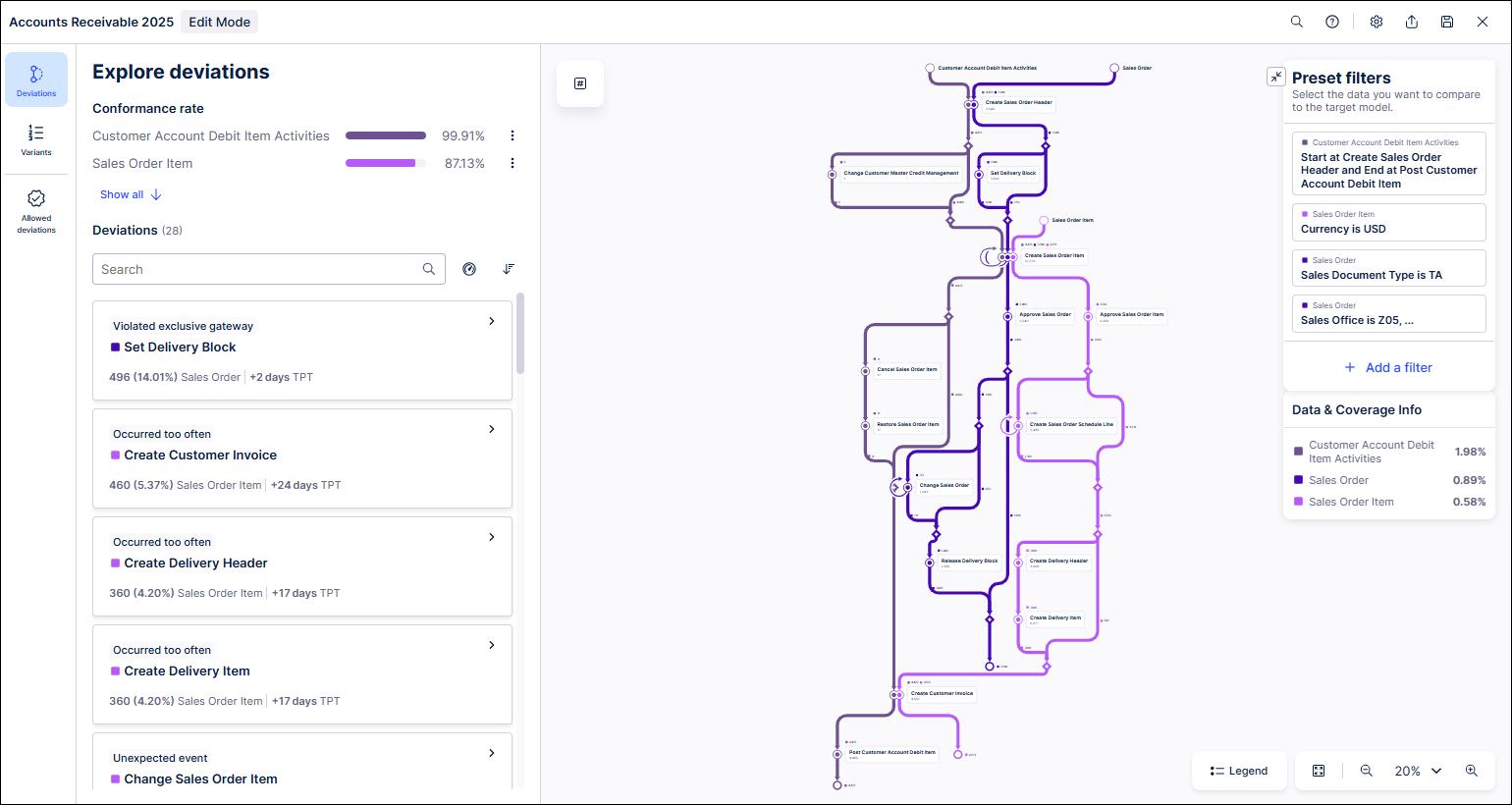

  1. Open your target model.
  2. Select the deviations tile. The Explore deviations screen opens. Any filters you applied when creating your target model are displayed. You can remove or edit them here or add new filters.
  3. In Deviations, deviations display for all event logs, with each deviation including the:
    Deviation category. Event log and event where the deviation occurs.
    Percentage of cases across all event logs (weighted average) the deviation occurs in.
    Impact on the throughput time caused by the deviation.

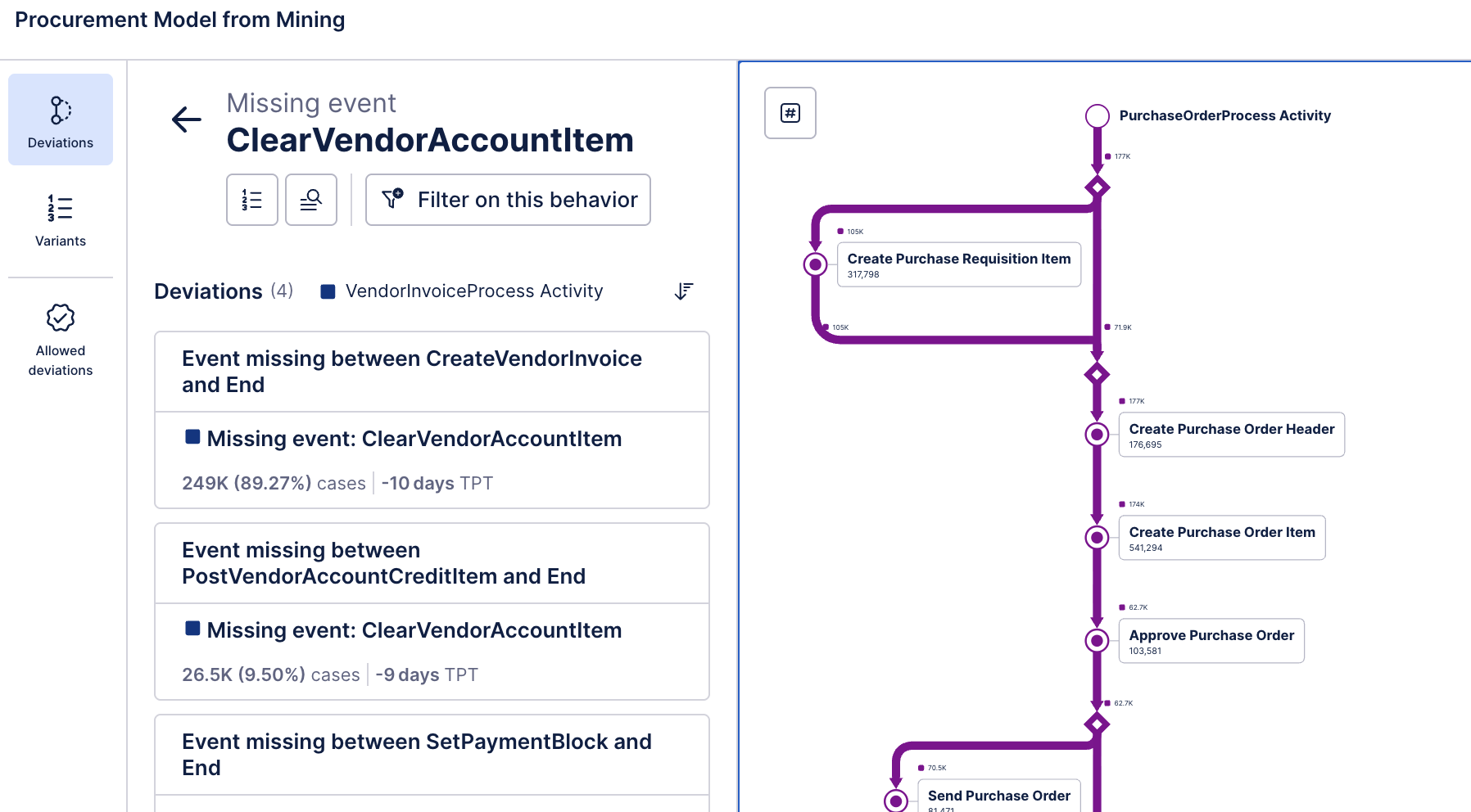

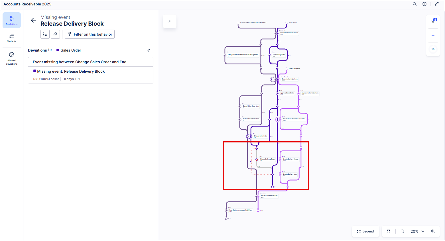

  4. Select any deviation to view more details about that deviation.The dashed line shows where the deviation occurs. Here, the deviation is a missing event.

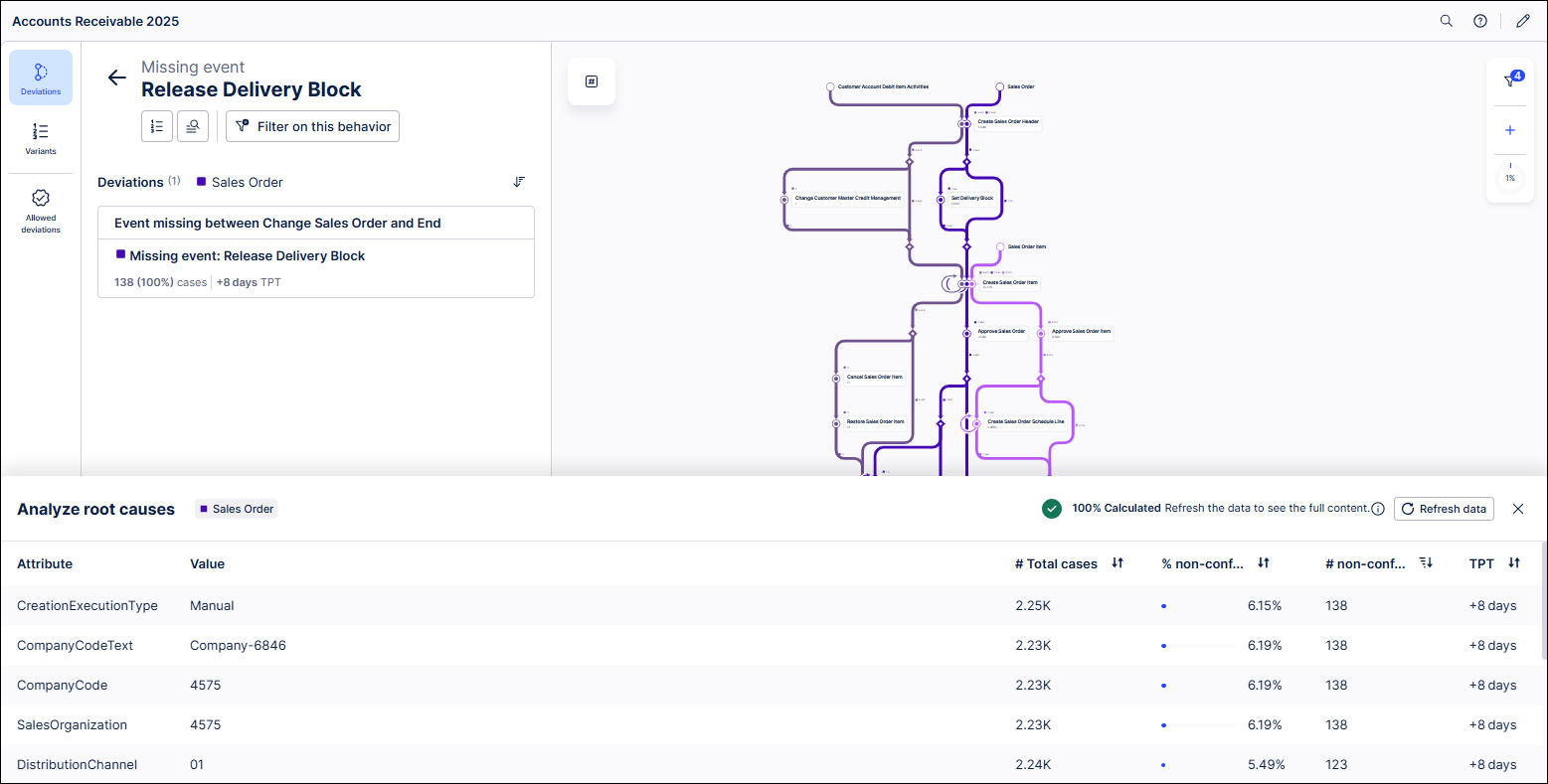

  5. Select the magnifying glass icon to analyze the root causes of the deviation .A table that displays detailed information about the selected deviation appears. You may need to select Refresh data to ensure all data is displayed.
