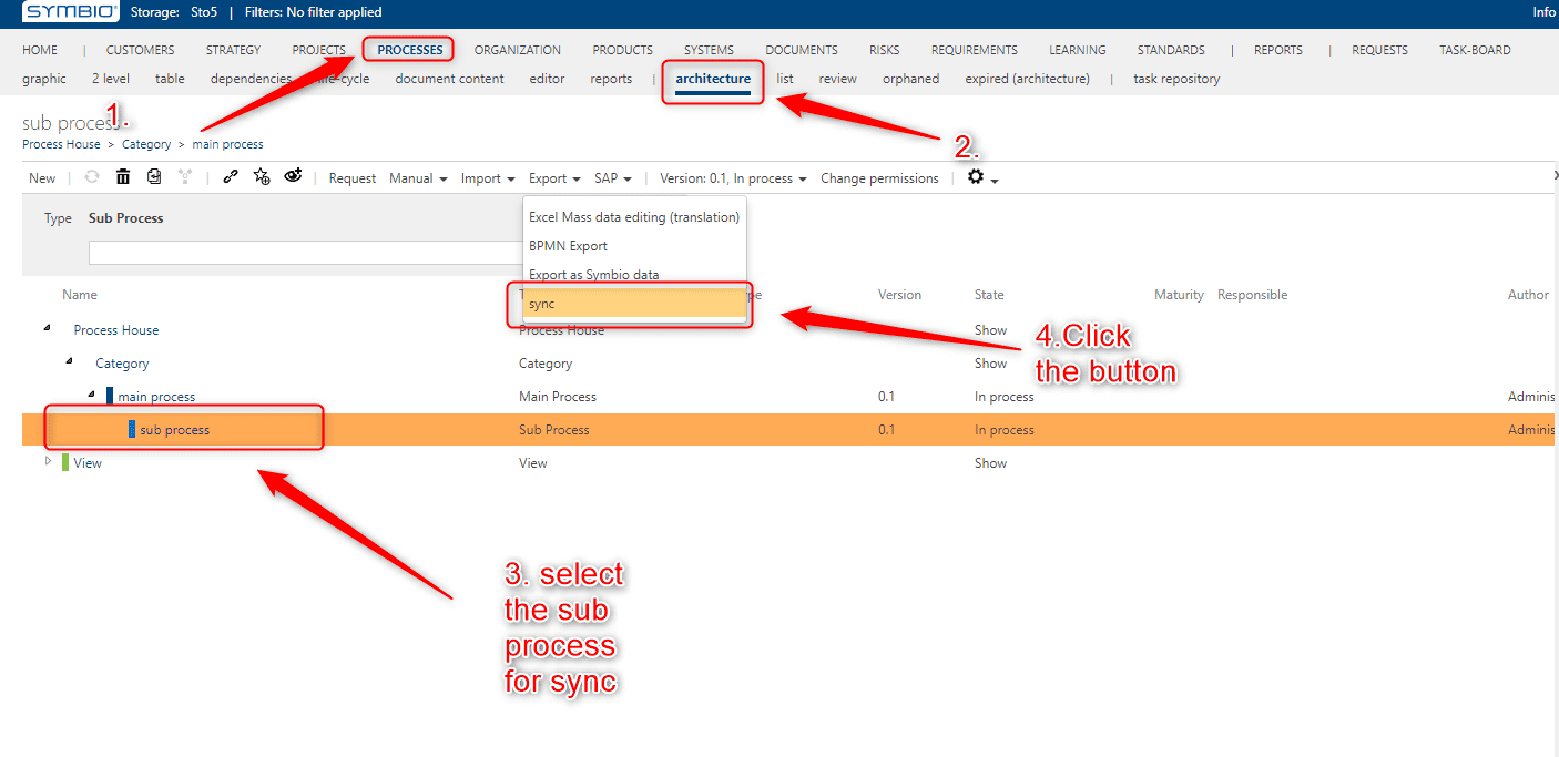

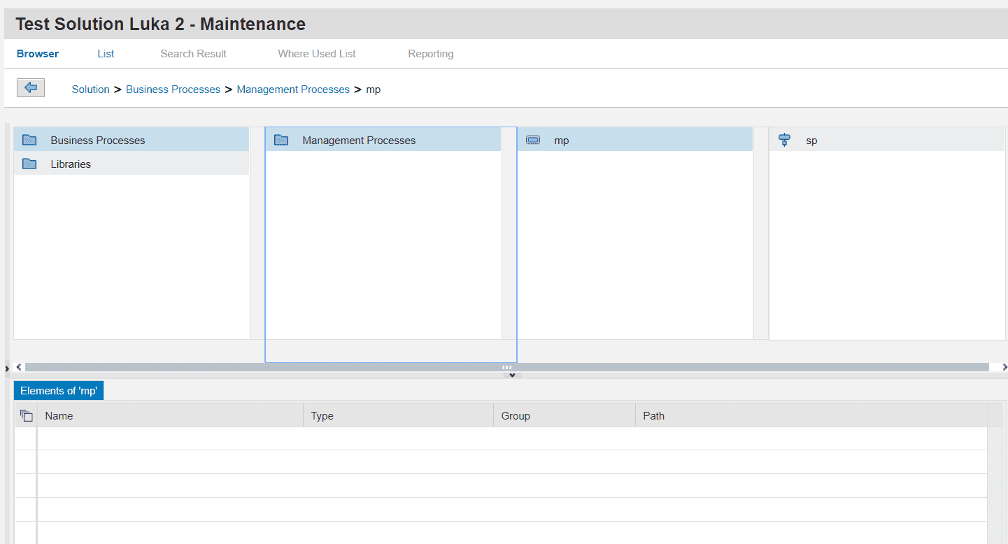

Select the sub process you want to synchronize and select “sync” from the Export dropdown menu.
Once the button is clicked the synchronization is started. In a few seconds you can navigate to the SAP Solution Manager branch and check if the structure is synchronized.

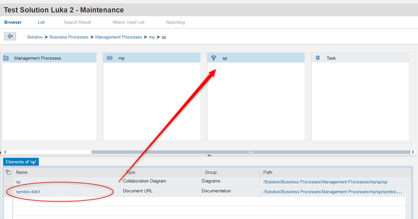

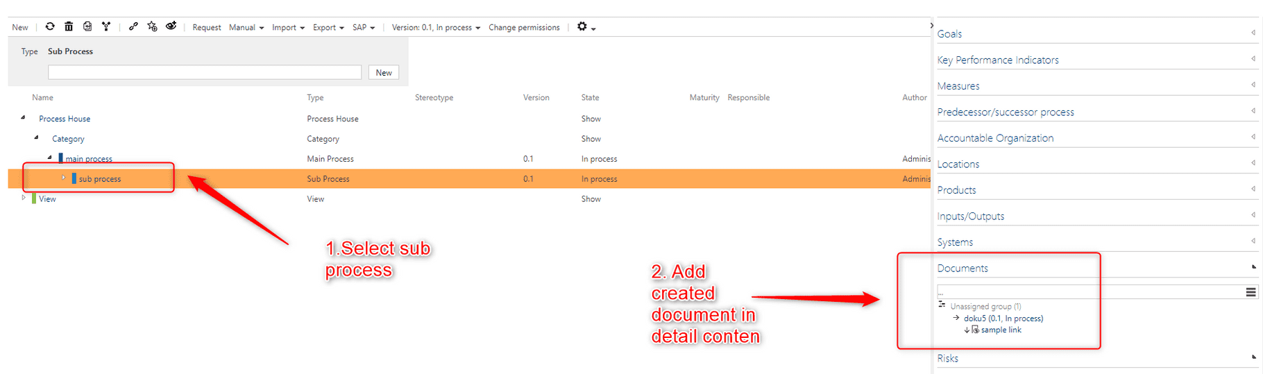

Documents can be synchronized if they are attached to sub processes or main processes as corona elements. First create a document in documents-architecture. Add an attachment to the document that contains the ULR to an online document.
Go to processes-architecture. Select the sub process and add the created document to it.
Synchronize the sub process and the document will be shown.

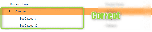

A category can have multiple categories as a child elements.

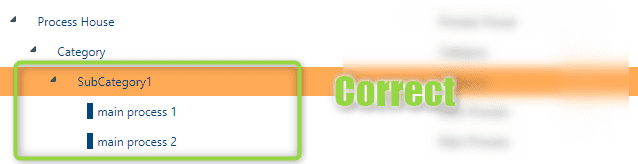

2. A category can have multiple main processes as child elements.

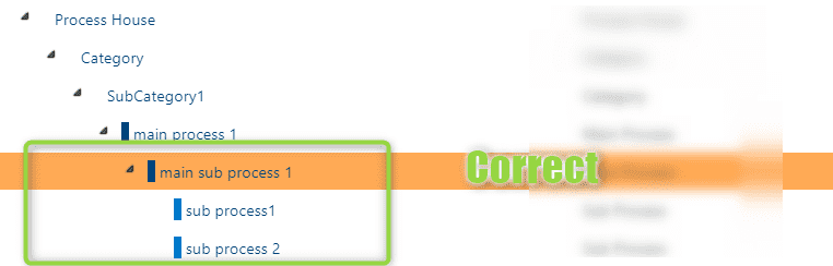

3. A main process can have multiple main processes as a child elements.

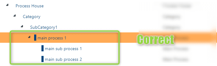

4. A main process can have multiple sub processes as a child elements.

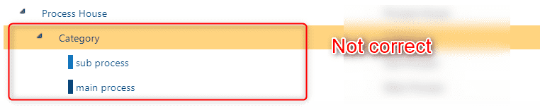

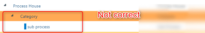

A category should not have a sub process as a child.
2. A main process should not have a main process and sub process as child elements.

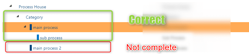

4. Main processes that do not have a sub process as a child or a leaf will not be synchronized.

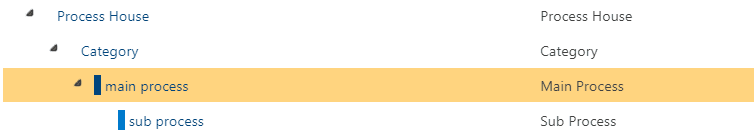

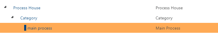

In the following structure:
The sub process is selected and synchronization between Celonis Process Management and SAP Solution Manager is done. The sub process is deleted in Celonis Process Management.

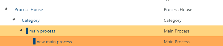

Instead a new main process is put.
The synchronization is not possible. Once the synchronization of a main process that has a sub process has been completed, it is no longer possible that this main process has main processes as children.
This is because a main process can be represented in SAP Solution Manager with two types depending if it has sub processes as children.
The recommended action is to delete the main process also and start creating this part of the structure from the beginning.
