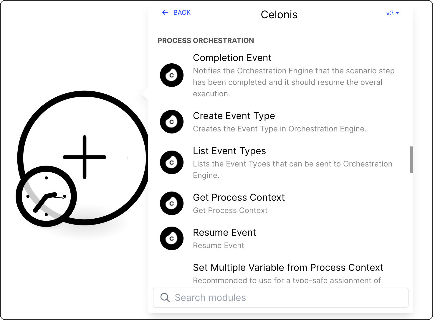

The orchestration modules are responsible for interactions between Orchestration Engine and Action Flows. These modules allow the two applications to communicate. They are used as triggers, mid triggers, updates of process context, or for notifications when an Action Flows's execution is complete.
Action Flow builder menu displaying a list of available Process Orchestration modules. The list includes options like Completion Event and Create Event Type, with a search bar at the bottom to quickly locate specific modules.
The completion modules are responsible for sending notifications to Orchestration Engine when an Action Flow is finished. They also send event data that is saved in the process context of the running Process Orchestration instance. For this, they need the instance ID from the starter module and the Event that is an outcome of running the Action Flow step.
  • Completion Event - the module is used for sending notifications about a completed Action Flows.

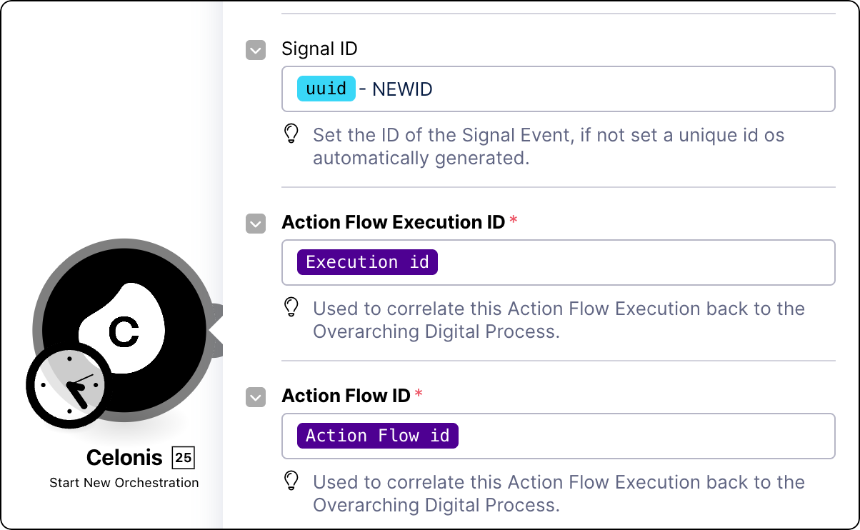

  • Start New Orchestration - the module can be used as a trigger for a new Process Orchestration instance. Using the module, you can connect with any other application. When such a connection is configured, any signals or actions from the connected app work as triggers for the orchestration.

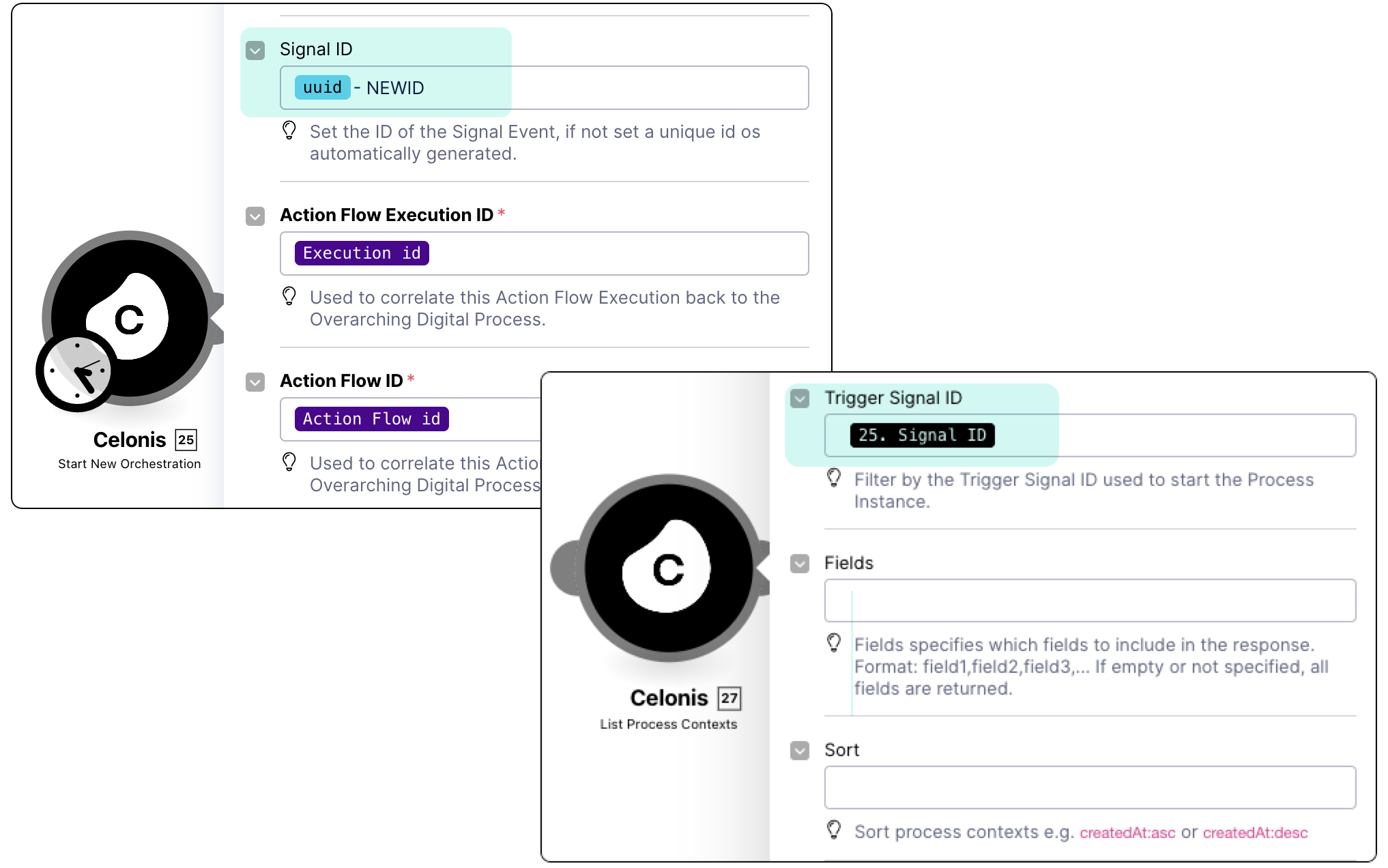

    In the Start New Orchestration module, you can set your custom ID of the Signal Event. You can reference this ID the Get Context module to learn what digital processes were started by what event instance.
    Screenshot shows on one side the Start New Orchestration module settings with the custom Signal ID defined and then on the the right hand side, the List Process Context module settings with the same Signal ID referenced as a trigger.
