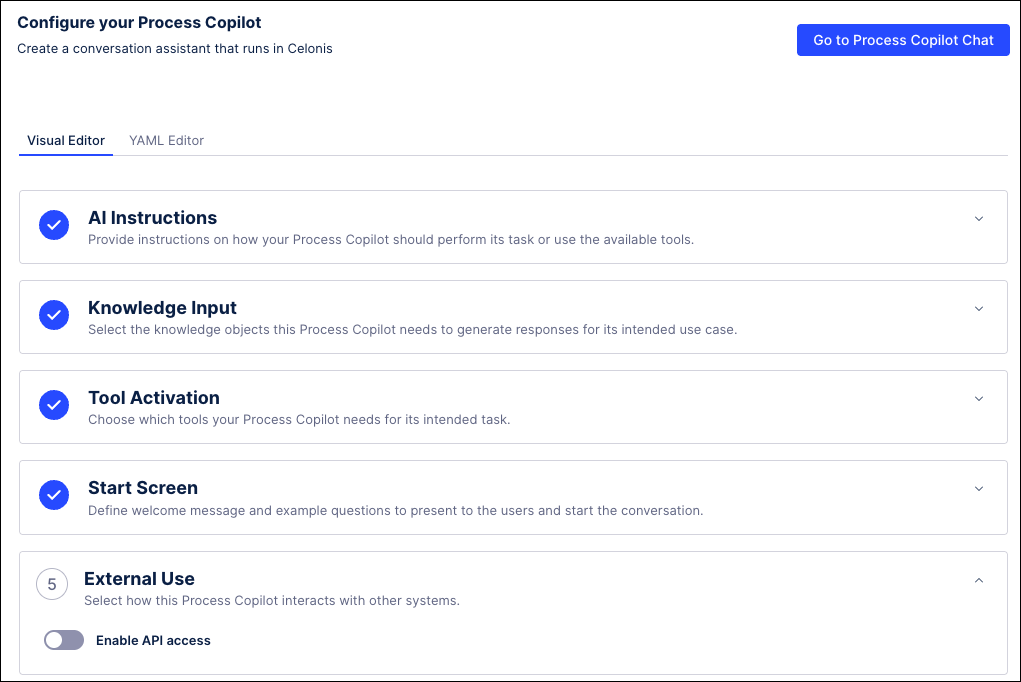

  1. Click the External Use section to expand it.
    Screenshot showing a Process Copilot configuration with all required sections completed.

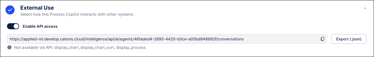

  2. Toggle the Enable API access switch to activate external access.
  3. To connect to this Process Copilot directly using the URL, click the Copy icon on the right side of the field and then paste the URL for this specific Process Copilot in your third party application.
  4. To connect to this Process Copilot using an API, click the Export (.json) button to download the OpenAPI specifications for this Process Copilot.
  5. Remember to check below the URL field for any tools in this Process Copilot that are not available via API.
  6. Click the toggle switch again at any time to remove external access.
