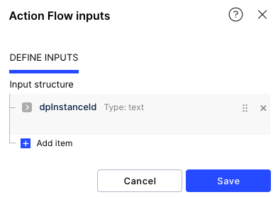

  • In your Action Flow, add a new input called dpInstanceId and set the input type to text. Note that the input name value is case-sensitive.
    Action Flow inputs field with a new input called dpInstanceId of the text type added.

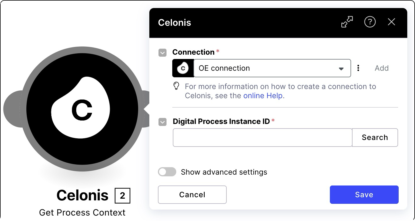

  2. Click Add module and from the list select Celonis > Get Process Context.
  3. Add a connection to the module:
    • If there's an existing Process Orchestration in this Studio package, you will see the Orchestration Engine connection in the list.
    • If there's no Process Orchestration in this Studio package, you have to create the OAuth connection manually before you can add it to this module. To learn how to do that, see Registering your OAuth client.

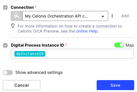

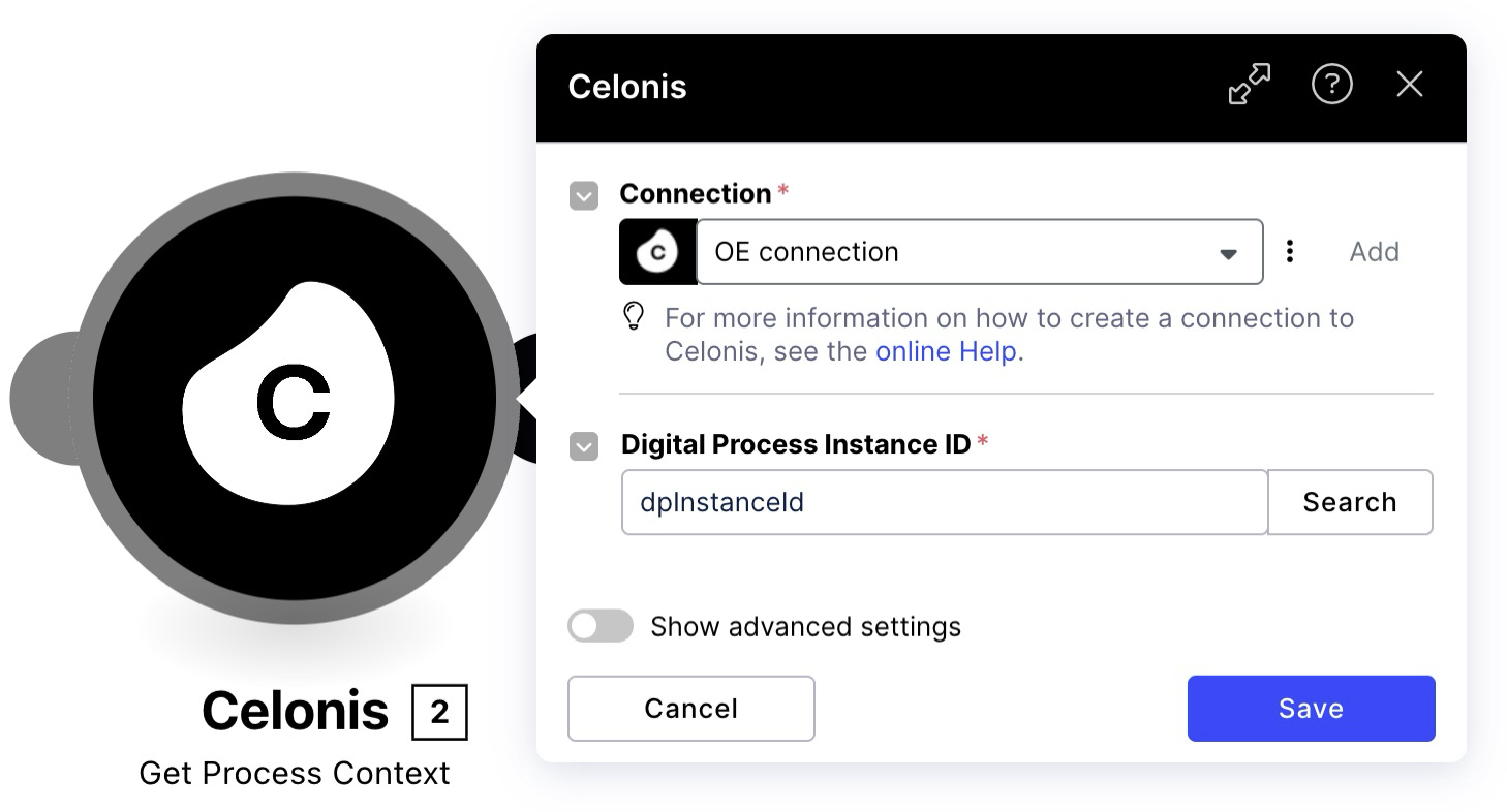

  4. In the Digital Process Instance ID, use the dpInstanceId variable.
  5. Save your changes.
