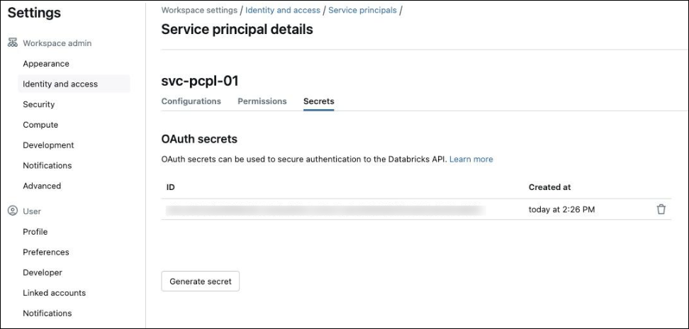

To enable OAuth authentication for a service principal, you must register the application in Azure Active Directory and create a client secret. For a complete walkthrough, see the Azure Databricks documentation – Configure OAuth M2M authentication.

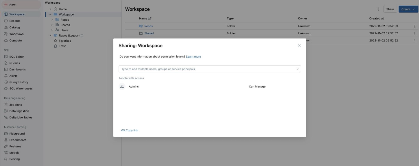

To ensure proper access, assign the following permissions to the service principal:

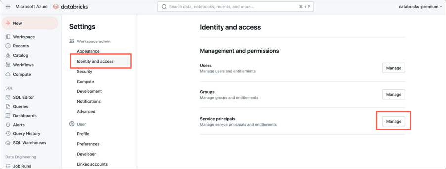

Roles and entitlements can be managed directly in Databricks under Settings > Identity and Access > Service Principals, or through Azure Active Directory role assignments.
  • Allow Workspace access – Allows the service principal to connect to the Databricks workspace.
  • Allow Databricks SQL access – Enables querying data in SQL warehouses.

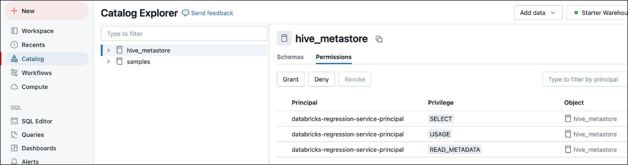

  • Catalog privileges – Grant SELECT, USAGE, and READ METADATA on the catalogs or schemas used for extraction.

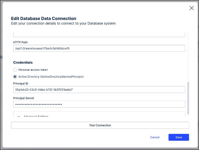

For Credentials > Active Directory in the extractor configuration, provide the following authentication values:
  • Principal ID – The client (application) ID of the service principal.
  • Principal Secret – The client secret created in Azure Active Directory for the service principal.

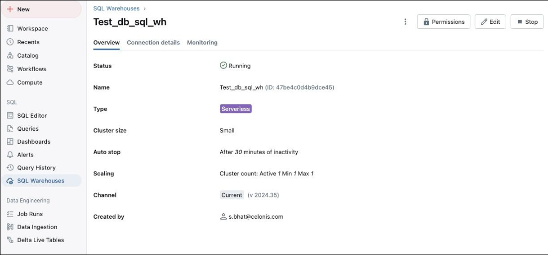

        • For HTTP Path, The Databricks endpoint path used to connect to your SQL warehouse or cluster. The Databricks endpoint path used to connect to your SQL warehouse or cluster. You can find this in your Databricks workspace under SQL Warehouses → [Your Warehouse] → Connection Details. The value typically looks like /sql/1.0/warehouses/<warehouse_id>.
