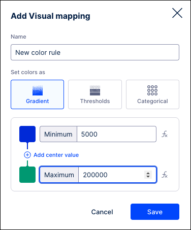

By using gradient coloring, you can choose how your values are colored based on their relation to the minimum, center, and maximum values assigned.
  1. In the Add Visual mapping window, enter a name for this color rule and click the “Gradient” option.
    Screenshot of the Add Visual mapping window for KPIs for the Gradient option selected.
  2. Enter the lowest and highest values you want to display. Click the color swatch to assign a different color to either value, or leave these fields blank to include all data.
  3. Click the Add center value link and repeat these steps to assign a central value if needed.
  4. Click Save when finished.

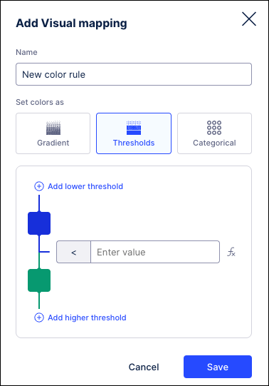

By using threshold coloring, you can define the point at which your values change colors. Values above and below your specified threshold values will display in the assigned colors. You can further configure this mapping by adding more threshold levels above or below the initial value. Values in your View will change color when they exceed or drop below any of the assigned threshold.
  1. In the Add Visual mapping window, enter a name for this color rule and click the “Thresholds” option.
    Screenshot of the Add Visual mapping window for KPIs for the Threshold option selected.
  2. Enter the threshold value in the field provided.
  3. Click the color swatches to choose a different color for values higher and lower than the threshold value.
  4. Click the Add lower threshold or Add higher threshold links to assign additional threshold values and assign colors.
  5. Click Save when finished.

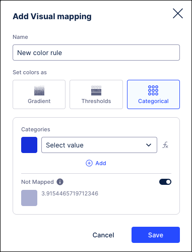

  1. In the Add Visual mapping window, enter a name for this color rule and click the “Categorical” option.
    Screenshot of the Add Visual mapping window for KPIs for the Categorical option selected.
  2. In the Categories section, select a value from the dropdown.
  3. Click the color swatch to assign a different color.
  4. Click the Add link.
  5. Repeat these steps to assign additional values to this color mapping.
  6. Click Save when finished.
