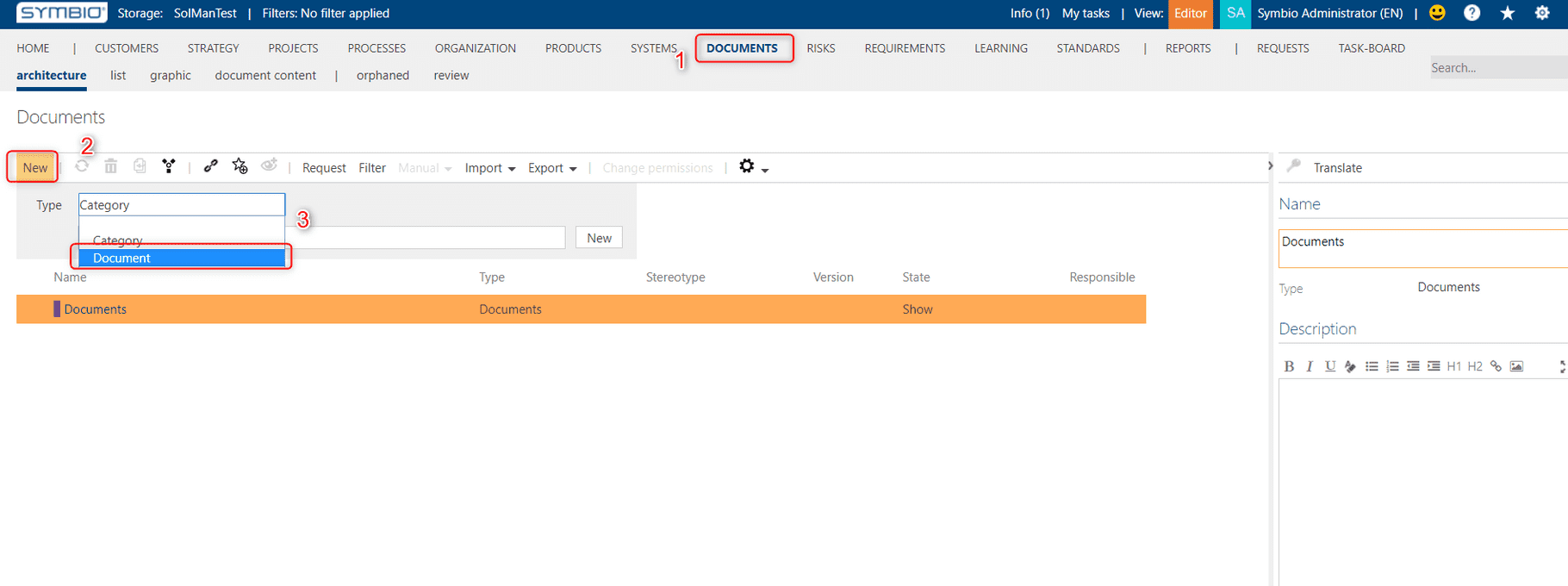

  • You must have at least the Analyst role to create documents in Celonis Process Management.

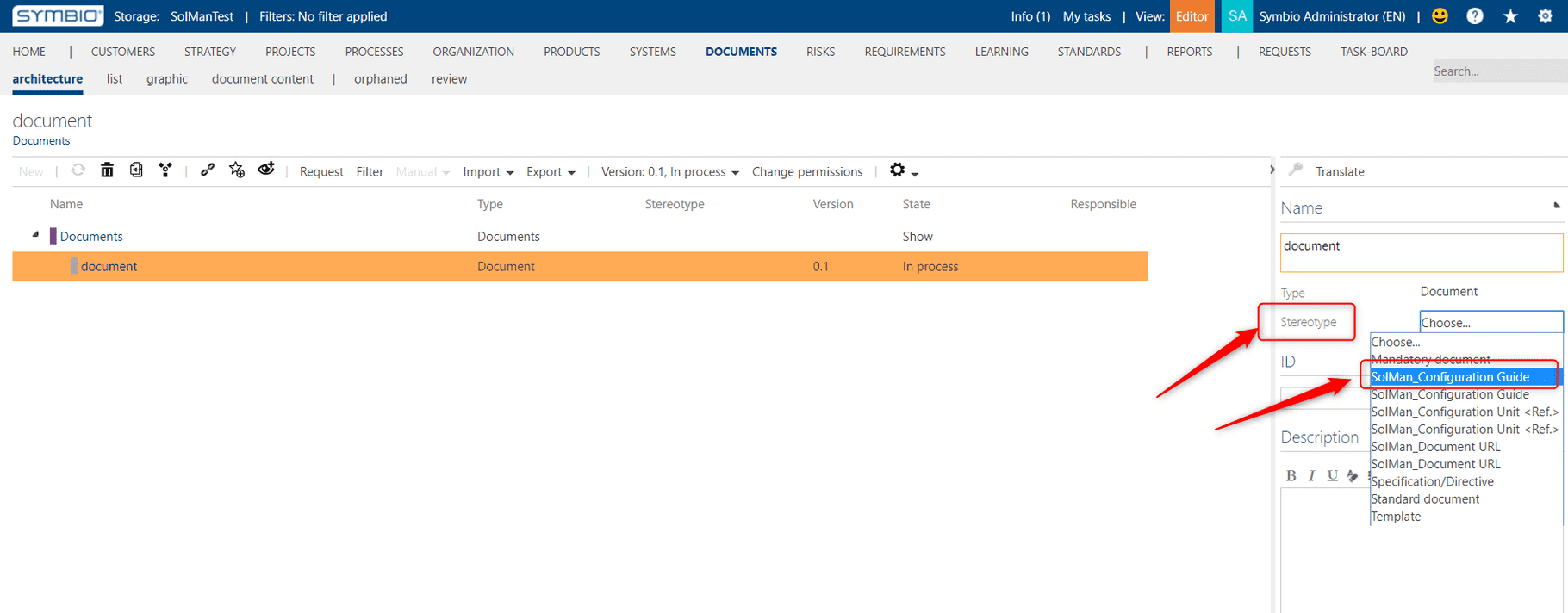

You can create a document in the documents facet:
There are two attributes you have to set for the document to be able to synchronize to SAP Solution Manager. On the linking action when Celonis Process Management storage and SAP Solution Manager branch are linked, all of the document types that are in the scope of the SAP Solution Manager solution of the branch that is being linked will be inserted into Celonis Process Management like document stereotypes. They will all have the prefix SAP Solution Manager.
Choose one of those stereotypes for your document so that it can be synchronized.

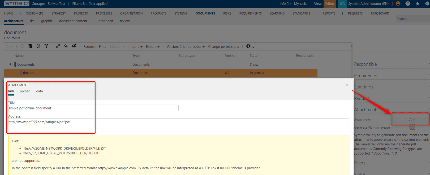

Add an attachment to the document. Only links will be synchronized, either to the online documents or to the physical documents.

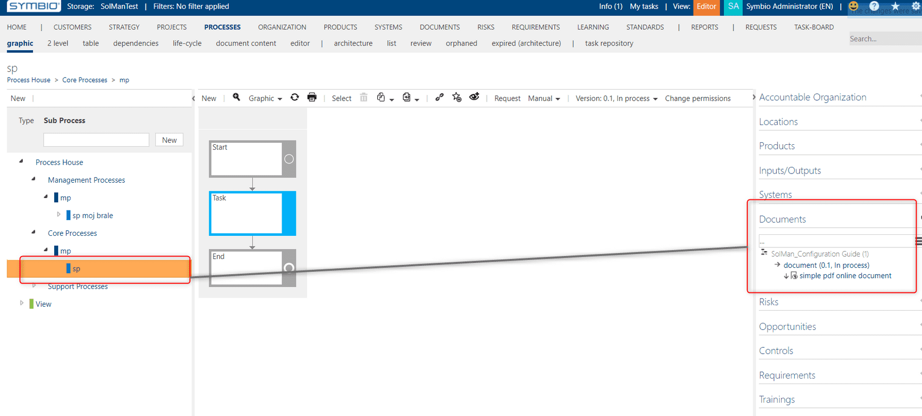

Attaching a document to the element in the process structure
You can synchronize the document attached on the sub process, main process and task by attaching the document to it.
Synchronizing the structure to SAP Solution Manager
Synchronize the sub process as usual. In SAP Solution Manager you should see the attached document.
If the document connection is removed in Celonis Process Management, the document connection will also be removed in SAP Solution Manager.
