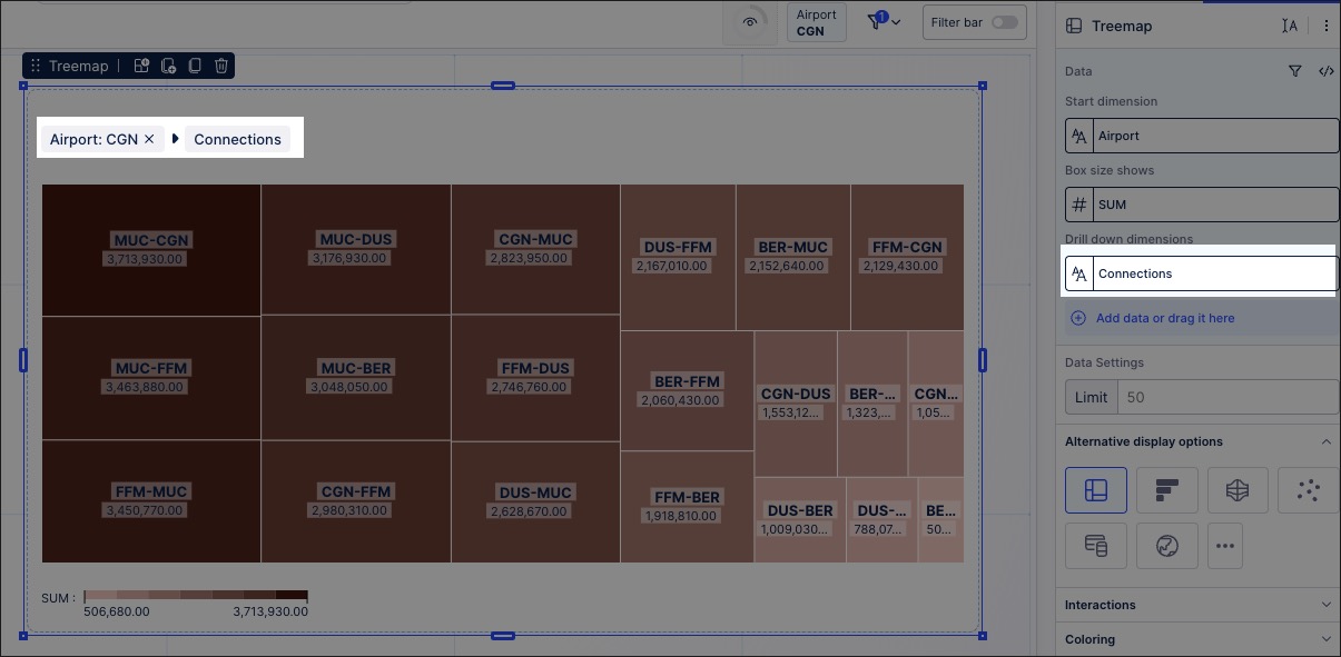

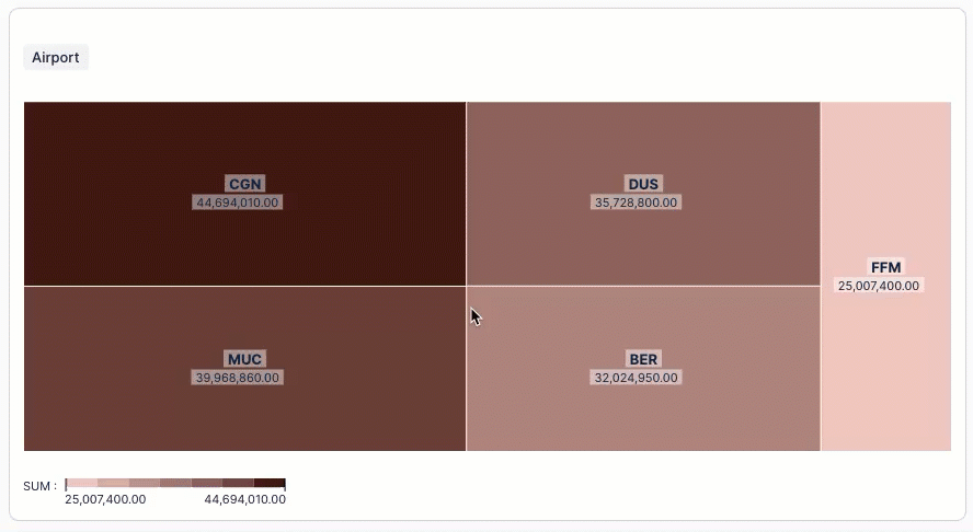

In this example, a treemap is used to display the most frequent flight connections between German airports. The darker the color, the higher the number of connections, with MUC to CGN being the most frequently flown during the time period.
In Studio, you can configure a treemap component using at least one dimension and one metric, with additional dimensions added when you want users to see further details.

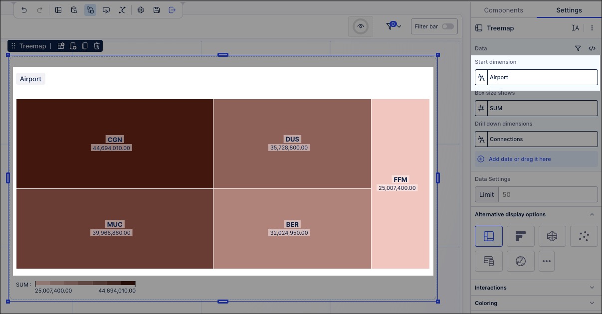

    • Start dimension: Choose the dimension that you want to display in the treemap.
      For example, the main airports in Germany.

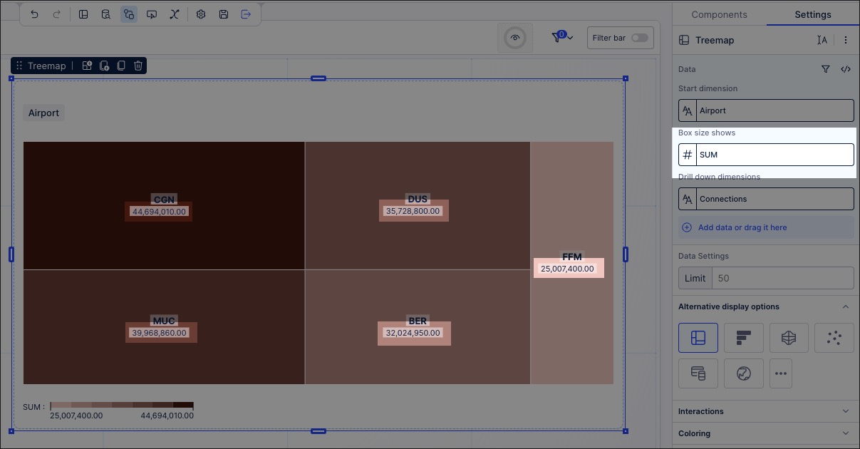

    • Box size shows: Choose the metric that your dimensions should be displayed in.
      For example, the total number of passengers in a year.
    • Drill down dimension: Choose an additional dimension that your users can see when they click into the starting dimension on the treemap.
      For example, the number of connections made between airports.

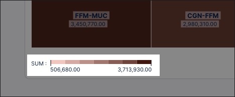

    • Coloring: Choose whether to color your boxes by gradient or threshold.
