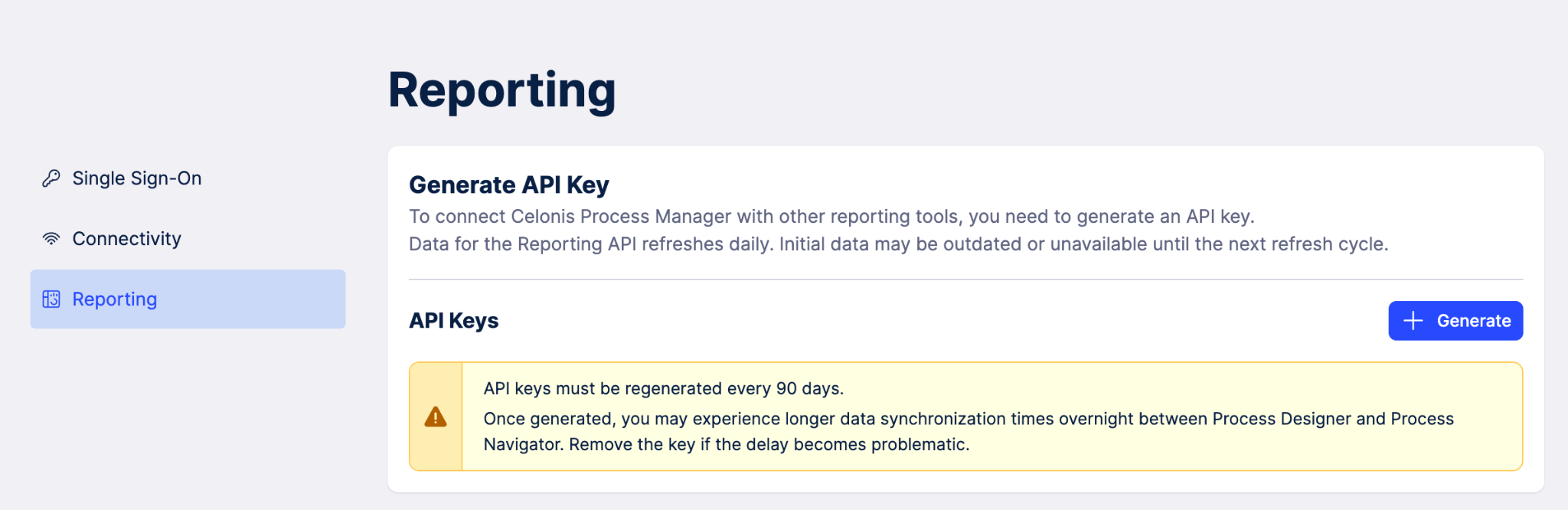

  1. Log into Process Navigator. In the top-right of the Process Navigator home page, select the dropdown next to your login name. Click Admin & Settings .Click Reporting in the left-hand navigation.
  2. Follow the prompts to generate an API key. Make sure to keep this key somewhere safe, because you will not be able to copy it again when you leave this screen.
    If you lose your API key, you will need to regenerate a new one.
  3. Use the key in any 3rd party reporting tool that ingests API keys.
    Data in CPM is refreshed every 24 hours. There may be a delay between when you create the key and when the data shown in the 3rd party reporting tool updates.
The key generated by the Reporting API is valid for 90 days. After the 90 day period, you will need to regenerate a new key to keep using the connection with 3rd party tools.
Regenerating overwrites any existing key, even if its within the 90 day period.
