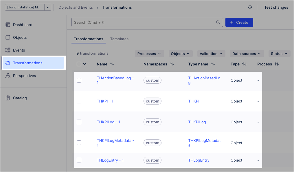

  1. Click Data - Objects and Events and open your Marketplace Installed Pool.
  2. Click Transformations.
  3. Open the transformation listed in the table below and repeat steps 4, 5, and 6 for each transformation listed.

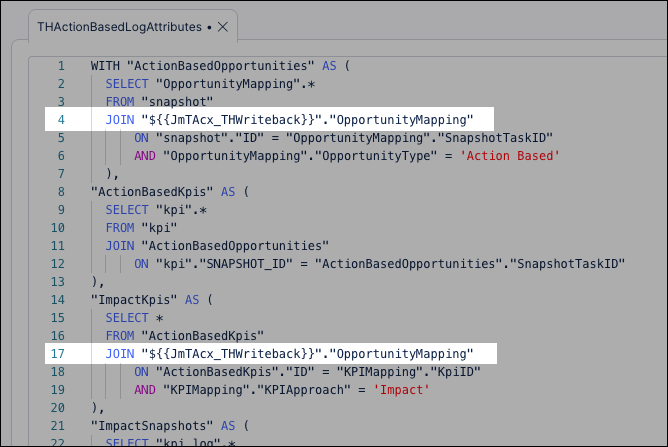

  4. Replace the Existing Mapping strings with the Replacement strings at the specified lines.

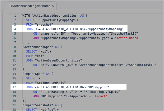

    For example, the THActionBasedLog - 1 transformation needs to be updated at lines 4 and 17:
    Existing Mapping strings:
    Replacement strings:

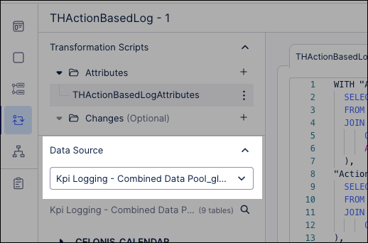

  5. For each of the four transformations, set the Data Source to KPI Logging - Combined Data Pool.
  6. After updating each of the four transformations, click Save with validation.
4
"${{JmTAcx_THWriteback}}"."OpportunityMapping"
<%=DATASOURCE:TH_WRITEBACK%>."OpportunityMapping"
17
"${{JmTAcx_THWriteback}}"."KPIMapping"
<%=DATASOURCE:TH_WRITEBACK%>."KPIMapping"

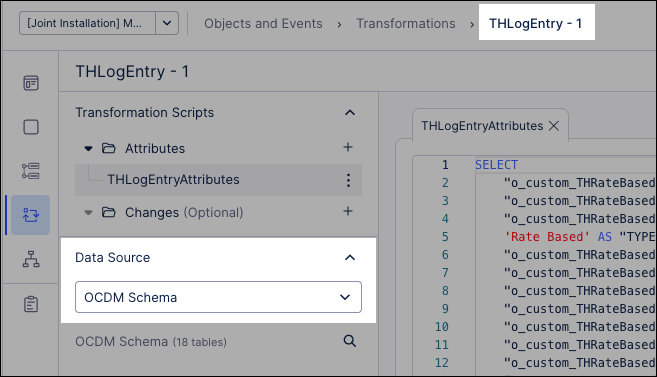

Unlike the specific Action, Rate, or Non-Monetary logs, which aggregate data from external writeback tables,the THLogEntry acts as the "master index" or header for all log entries. It must remain within the core OCDM Schema to maintain referential integrity with the central Object-Centric Data Model. Using the Combined Data Pool here would break the relationship between the specialized logs and the primary process objects.
To update the THLogEntry data source:
  1. From the Transformation overview page, open the THLogEntry transformation.
  2. Click the Data Source drop down and select OCDM Schema.
  3. Click Save with Validation.
  4. Use this opportunity to ensure that all other transformations used the KPI Logging - Combined Data Pool data source.
