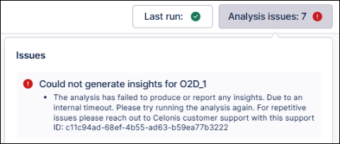

No insights generated / "Could not generate insights"
When running your Insight Explorer you get an error stating that insights could not be generated due to an internal timeout. One possible reason for this issue is running the analysis on large Knowledge Models with too many rows for the analysis to complete before timing out.
Screenshot showing an example of the "Could not generate insights" error message in Insight Explorer.
Error
Try reducing the number of rows being analyzed by applying filters to your configuration. Adding a filter to your Insight Explorer will narrow the scope of the data being analyzed which can help reduce the amount of time needed to generate insights by focusing on a smaller segment of your data.
