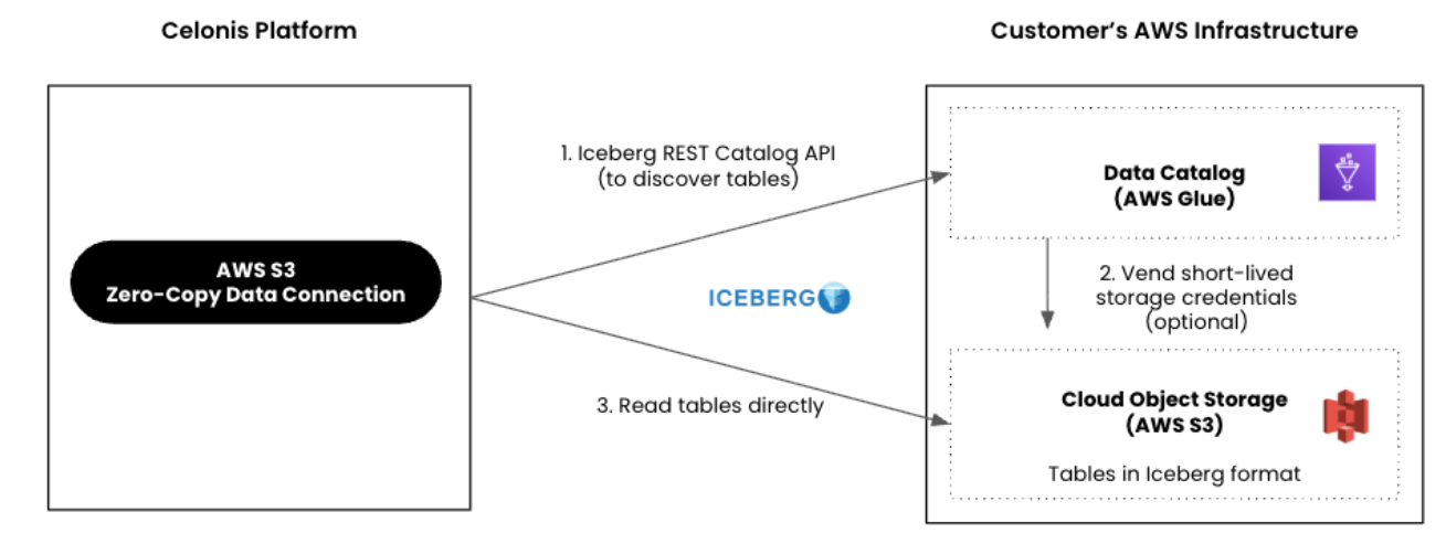

    A screenshot of a diagram showing the architecture between the Celonis Platform and an AWS Glue catalog using a zero-copy connection. The Celonis Platform establishes a connection, tables are discovered in the catalog via a short-lived credentials, and re

  • Data catalog and storage: Your data is stored in AWS S3 in the Iceberg format and is made available via an AWS Glue catalog.
  • Celonis Platform access: Both the AWS Glue Iceberg REST Catalog endpoint (Allowlisting Celonis domain names, IP addresses, and third-party domains) and the underlying S3 files must be accessible by the Celonis Platform.
  • Credential configuration restriction: AWS Glue must be configured to allow direct access to S3 (AWS Lake Formation's credential vending is not supported).

When connecting to Amazon S3 via zero-copy connections, select one of the following authentication methods based on your security infrastructure:
Method 1: Delegated access using assumed IAM roles (Recommended)
Create an IAM role in your AWS instance configured for delegated access. This role requires:
  • The required data access permissions assigned via an IAM policy (see Required data access permissions).
  • A trust relationship explicitly defining the Celonis external IAM role ARN as the Trusted Entity (Principal).
  • The Celonis External ID configured as a StringEquals condition within that trust relationship.
For a complete trust policy example, see Delegated Access Trust Relationship JSON.
Method 2: Access Key / Secret Key
Create a dedicated AWS IAM user to generate a static Access Key and Secret Key pair. You must attach the required data access permissions policy directly to this user.
