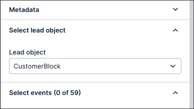

  4. Select lead object: Select the lead object for the event log.
    • Click Add input filter to configure which objects should be included and excluded from your event log. Using this filter will reduce the size of the resulting table, increasing the performance of your content.

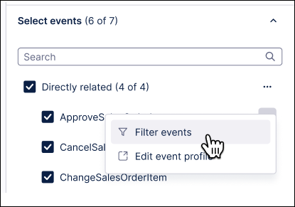

  5. Select events: Select the events that are relevant for the process you are tracing, using the event filters to include or exclude specific event instances from your event log. Like with filtering your objects, using this filter will reduce the size of the resulting table, increasing the performance of your content.

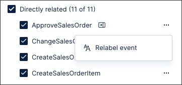

    1. Click the three dots by the name of an event type, and select Relabel event.
      A screenshot showing how to create an event log within a knowledge model.

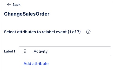

    2. Click Add attribute, and select an attribute from the list. The preview updates immediately to include the new attribute in the Activity Details column. You can select any number of attributes for any number of events in the event log.
      Selecting numerical attributes can produce a lot of different groupings - these are handled as separate events and may break certain limits, so be careful when selecting attributes with these data types.

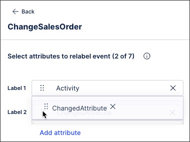

    3. Drag and drop the attributes to arrange them in the order you want. We'll concatenate the attributes in the order you place them.

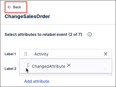

    4. When you've added all the attributes you want to, select Back.

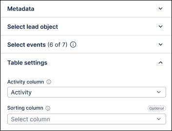

  7. Choose your event log table settings, including:
    • Activity column: Select which is the activity column to visualize in the Process Explorer. By default, 'Activity' is selected.
    • Sorting column (optional): Events with identical timestamps will be sorted according to the values in the selected column.
      While specifying a sorting column is optional, we recommend it if your data set includes activities that may have the same timestamp. If two activities belong to the same case and have the same timestamp without any configured sorting, the resulting process graph is based on implementation details (such as the alphanumerical order for CREATE_EVENTLOG). This can result in unwanted process variants.

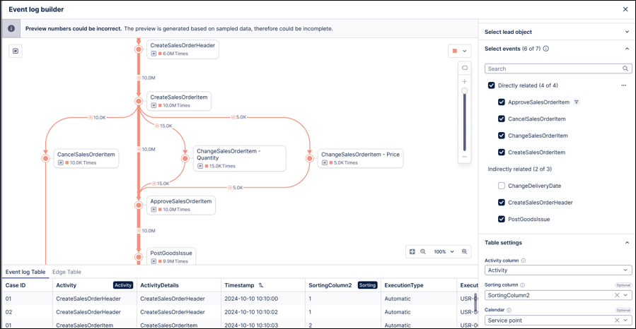

  8. Preview your process: Use the Process Explorer preview to validate your configuration in real-time.
    • The preview generates a visual representation of your process based on a sample of your data.
    • As you add or remove events or change the Sorting column, the Process Explorer updates to show how these changes affect the process flow and variants.
    • Use this to identify unwanted variants caused by identical timestamps before saving.

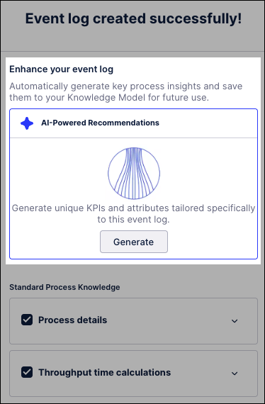

  9. Click Save .
When you save the event log, it’s added to your Knowledge Model, and the output tables are added to Records in your Knowledge Model. The event log won’t be visible in the perspective builder in the Objects and Events UI.

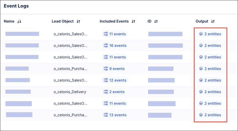

  2. Click the entities tag in the Output column for your event log:

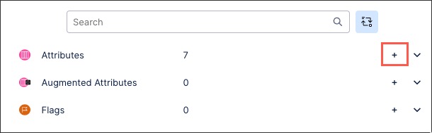

  4. Click + and set up the calculated attribute column in the editor.

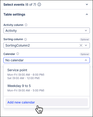

  3. Open Table settings and click Calendar - Add new Calendar.
  4. Configure the calendar:
    • Name: Add a unique name for the calendar, used as an reference.
    • ID: This is automatically derived from the name entered.
    • Working Hours: You have the option to add specific custom working hours for each day.
      • If your hours are consistent, you can use the "copy hours to all selected days" button to apply your settings in bulk.
  5. Click Save.
Once you save your configuration, it is stored as a reusable Knowledge Model entity. You can then reference it in your PQL queries using a variable (e.g., @yourCalendarName).
