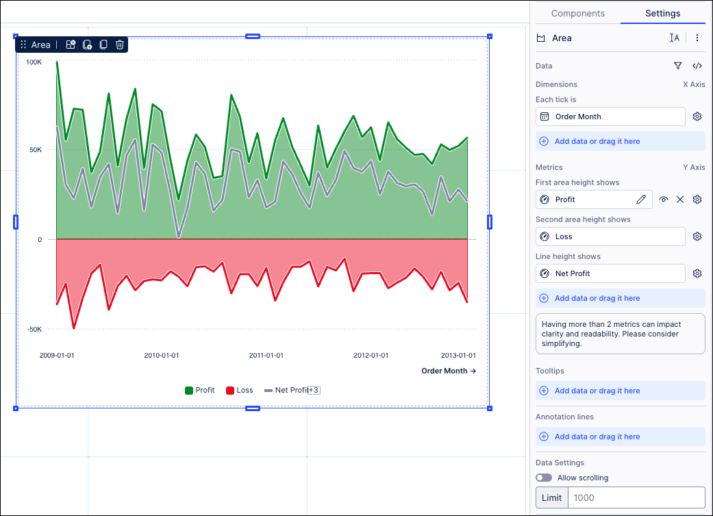

In this example, an area chart is used to display the profit (metric), net profit (metric), and loss (metric) levels per month (dimension). The chart shows:
Green area (profit): The total profit earned in each month.
Red area (loss): The total loss in each month.
Gray line (net profit): Represents net profit (profit minus loss).
X axis / Y axis: Order month (dimension), profit / loss (metrics)
From this chart, you can see that the net profit generally stays positive, since the green (profit) is consistently larger than the red (loss). There are repeating peaks and dips, suggesting possible seasonal patterns.

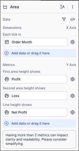

The area chart component can be dragged and dropped into your View, giving you the following options to configure:
Data: Use the PQL editor to select the data to display in your area chart.
Dimension - each tick is: Use the PQL editor to add the metric displayed on the X-axis. In our example, we've selected Order Month.
Metrics - first / second height area shows: Use the PQL editor to add the metrics you want to display in the chart. In our example, we've selected profit and loss.
Metrics - Line height show: Use the PQL editor to add the metrics you want to display as a line within the area chart. In our example, we've configured Net Profit (calculated as profit minus loss).

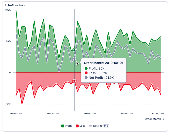

Tooltips: Decide if you want your chart to display information when you hover over it. In our example, when you hover over a point, the tooltip displays the exact data (e.g., profit = 35K, loss = –13.2K).

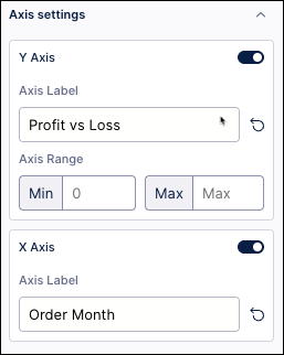

Axis settings: Enter custom distribution and dimension axis labels.
