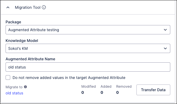

To migrate your record-based augmented attributes to the table-based format:
  1. Click Studio and then open the package containing the KM you want to create the augmented attribute for.
  2. Click Records and then select your record.
  3. In your record, go to the augmented attribute you want to migrate.
  4. At the bottom of the augmented attribute editor, go to the Migration Tool.
    • Package:Select the Studio package to use.
    • Knowledge Model: Select the Knowledge Model within the selected Studio package to migrate the augmented attribute to.
      To migrate an attribute to another Knowledge Model, add a new attribute to your source Knowledge Model record. This new attribute must have the CELONIS_MIGRATION_ATTRIBUTE ID.
    • Augmented attribute name: Add a name for the augmented attributes.
    • Do not remove added values: Select this option to copy data to the target attribute without overwriting its existing values.
  5. Click Transfer Data to copy over all values of the old augmented attribute value to the new one.
The migration tool count shows differences between old and new augmented attributes since the last transfer. Clicking Transfer Data replaces the new attribute’s values with the latest data from the old one. If all values are null, both versions match.
