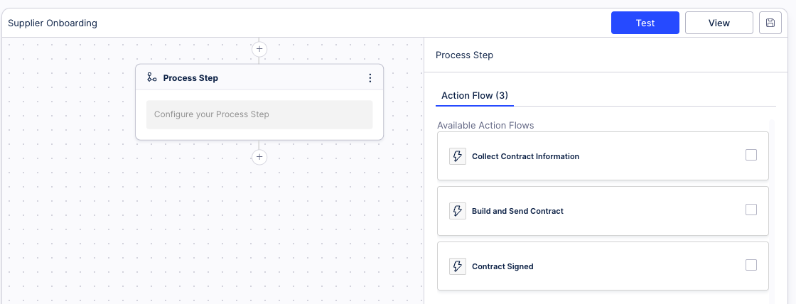

  1. In Studio, go to your package and select your Process Orchestration. If you haven't created any Process Orchestrations yet, see Creating Process Orchestration..
  2. Under a process step, click the plus icon and select Process step.
    Process Orchestration with a context menu for adding a new step open.
  3. From the right-hand side panel, select Add action.
  4. (optional) Define specific conditions for running this step. Click Create conditions.
  5. From the list of Action Flows available in your package, select ones you want to add to the step. You can also create Action Flows directly from here.

    The edit process step screen with a list of available Action Flows that can be added to the step shown.

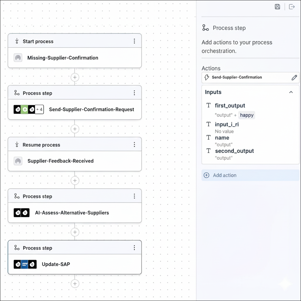

  7. Map any inputs that are defined for any of the Action Flows you selected.
    Input/Output Mapping provides an intuitive, low-code interface to ensure accurate data is passed between all automated steps. Right now, you can map Action Flow inputs and outputs directly within the Orchestration Engine step to streamline your workflow configuration. You can preview inputs defined for a given Action Flow, in a side preview in the Process Orchestration editor.
    Editing panel for a Process Orchestration step with the overview of inputs available for the selected Action Flow.
    For Action Flows, input types are defined in the Action Flow editor directly. See Action Flow inputs.
