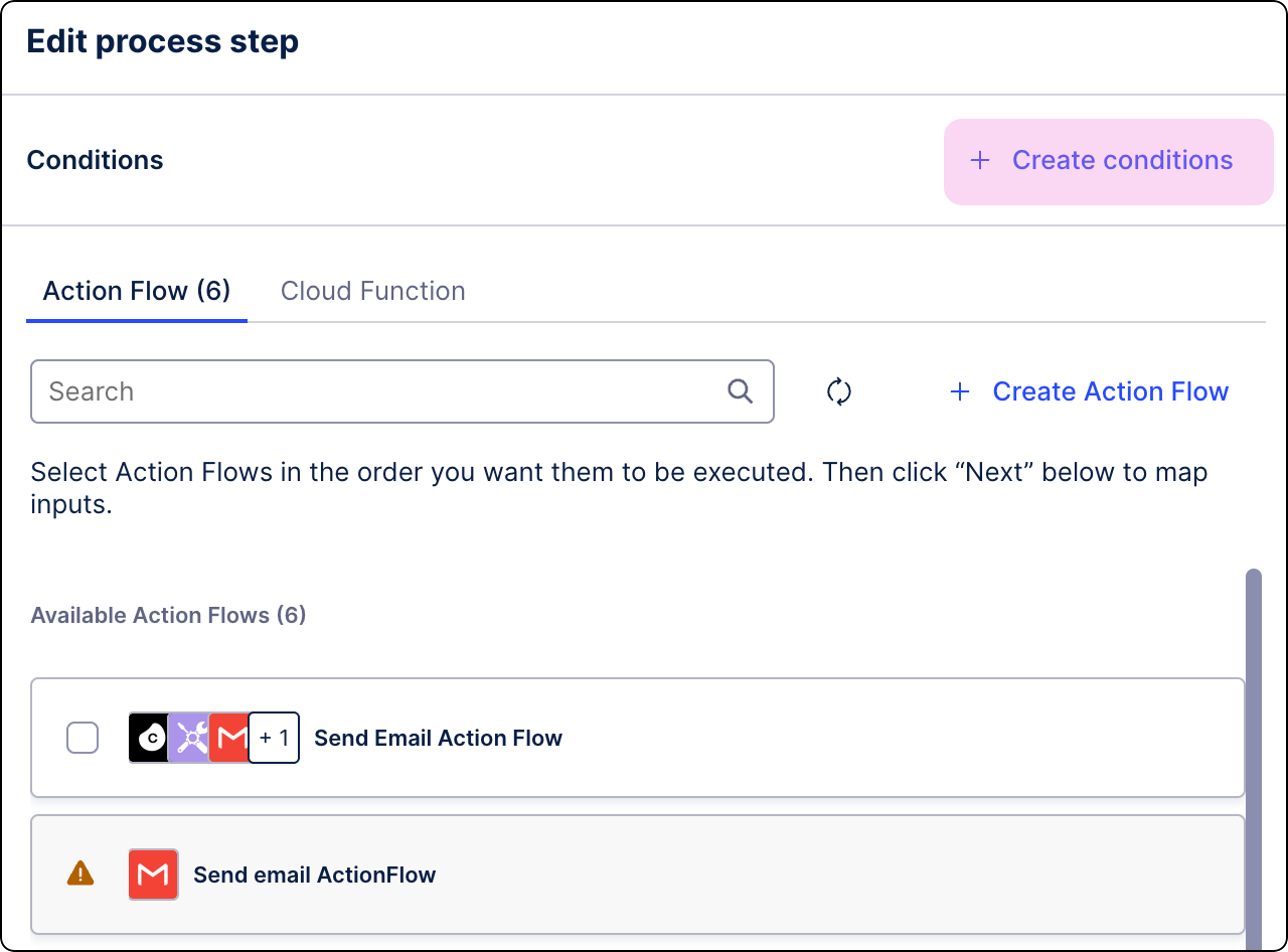

  1. In your Process Orchestration, edit one of the existing steps or add a new one.
  2. Select Create conditions.
    "Edit process step" interface showing a list of available Action Flows with the "Create conditions" button highlighted.
