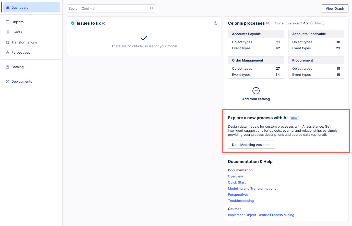

Model with AI in Objects and Events
The AI-powered Celonis Assistant in the Objects and Events module recommends a set of objects and events and the associated attributes and relationships based on your intended use case and the available data. The Celonis Assistant builds an initial model that you can conversationally refine by using the chat to explain what you do or don’t need in the model. You can also upload files and other examples to help explain to the Celonis Assistant what you need in your data model and then allow the Celonis Assistant to build it for you.

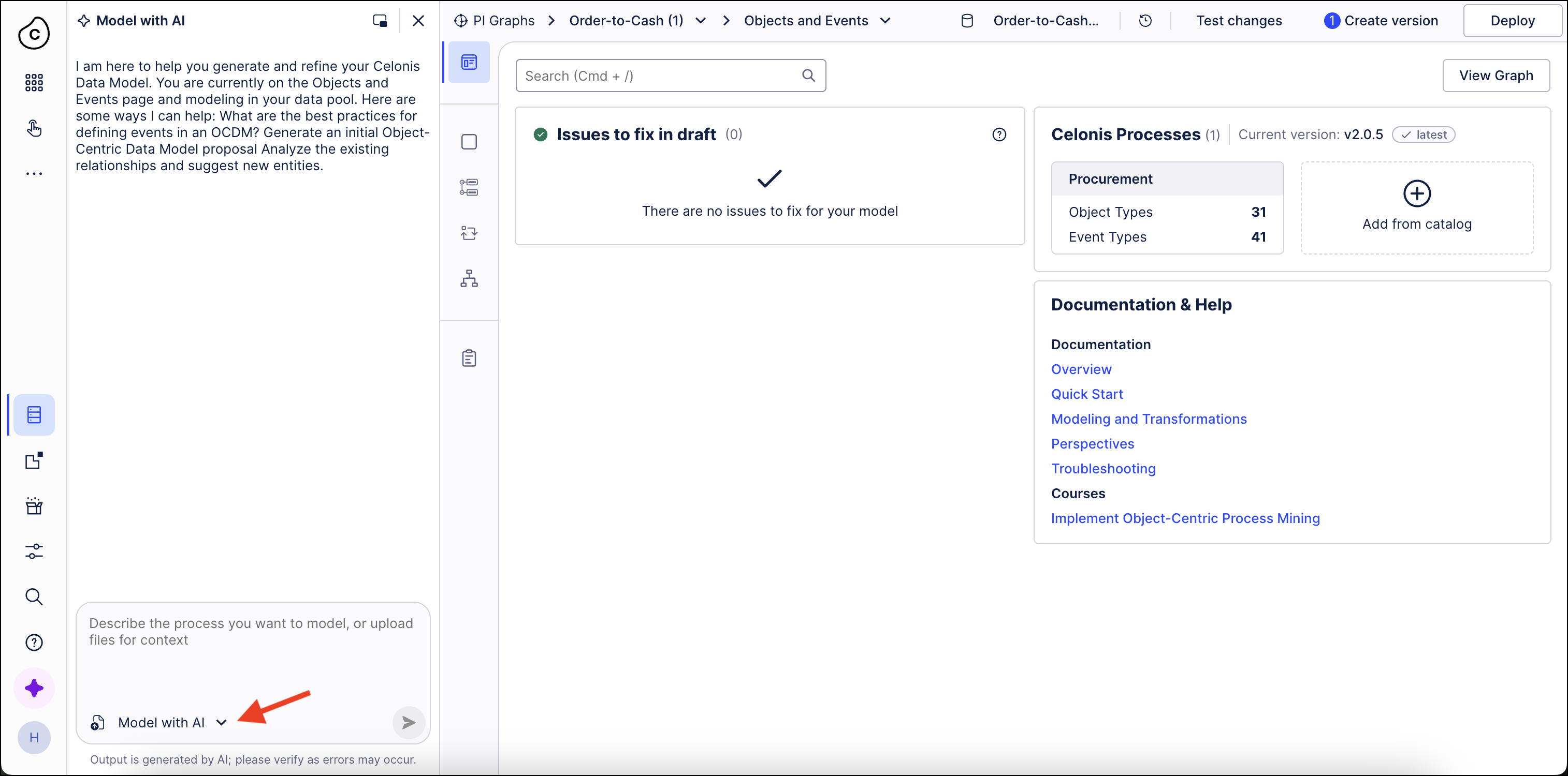

  1. To access the Celonis Assistant, click the Celonis Assistant button on the menu and then use the dropdown at the bottom to select "Model with AI".
  2. Use the chat feature to describe your request or use case in the prompt field in the chat window on the left. Click the icon to upload any attachments such as diagrams or process flows that help describe what you need in your model.

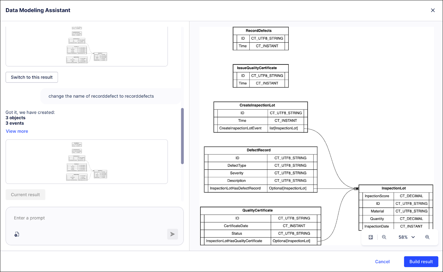

Each time you submit a message to the Celonis Assistant with more information, the model will be regenerated based on your request. The explanation of the current model will be updated in the chat to explain what objects and events are included, the associated attributes, and a description of the primary relationships in the model.
You will still be able to view previous iterations of the model in the chat and return to those configurations if a change doesn’t have the expected result by clicking the Switch to this result button.
Screenshot of the Data Modeling Assistant showing previous versions of the build in the chat window.
Once you are satisfied with the configuration of your model, you can add the  currently displayed model directly into your environment by clicking the Build result button. If you revert to a previous version of the model and then click the Build result button, that previous version you selected will be built into your environment.
