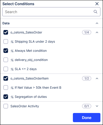

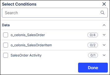

To add conditions, follow these steps:
  1. Select the Conditions button.
    The conditions saved in your knowledge model display.
    List of conditions saved in the knowledge model
  2. Select the conditions you want to add.
    List of conditions with some conditions selected.
  3. Select Done.
    The selected conditions are added to your baseline model.
