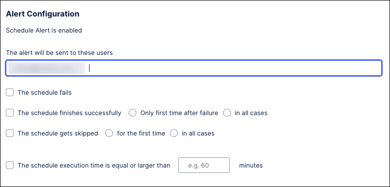

Schedule alert configuration: Configure email alerts for your schedule, with the ability to send notifications if the alert fails, skips, takes longer than a specified time, or is completed successfully. This can be enabled / disabled.
