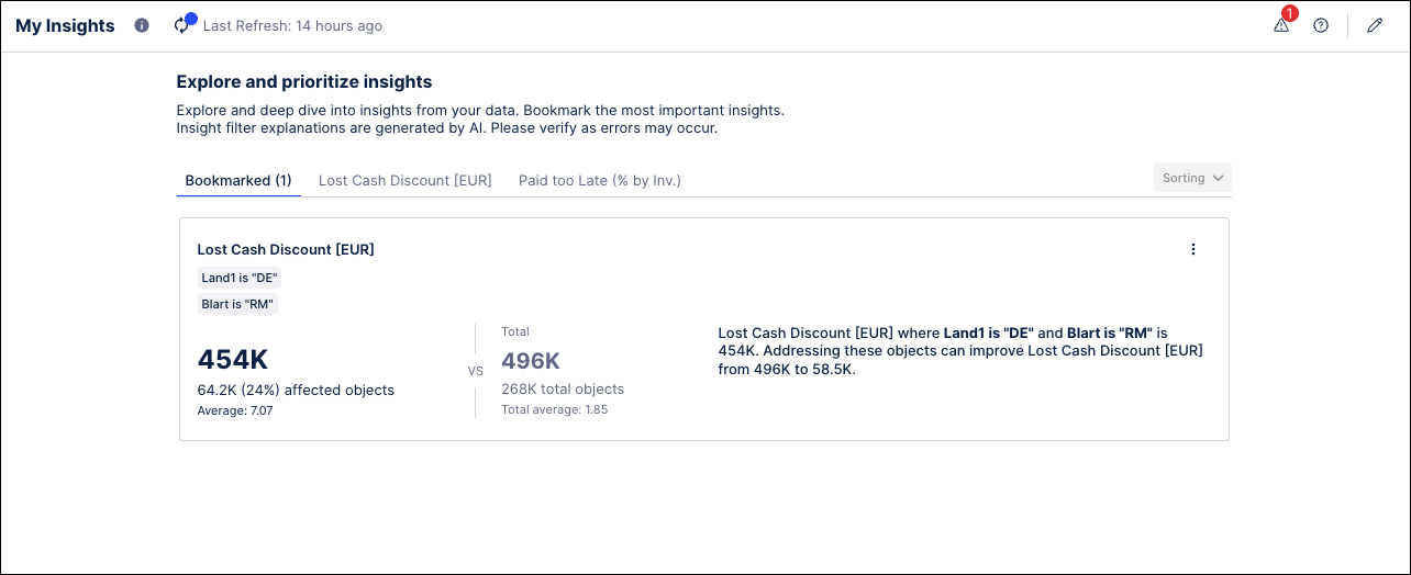

The Explore and prioritize insights page of Insight Explorer displays all the insights calculated from your selected data in the form of cards that you can click on to analyze further. Insights are ranked by potential improvement by default, but can also be filtered by the type of insight or sorted by the number of affected objects. Your insights are organized into tabs based on the type of insight and whether or not the insight has been saved for further analysis by selecting the Bookmark icon. You can click on any insight card to investigate the data further.
Screenshot showing an example of the type of insights generated by Insight Explorer.
Using the toolbar at the top of the page, you can rerun the analysis, see information about the analysis such as any issues that occurred during the run, and revisit the Configuration for this Insight Explorer.

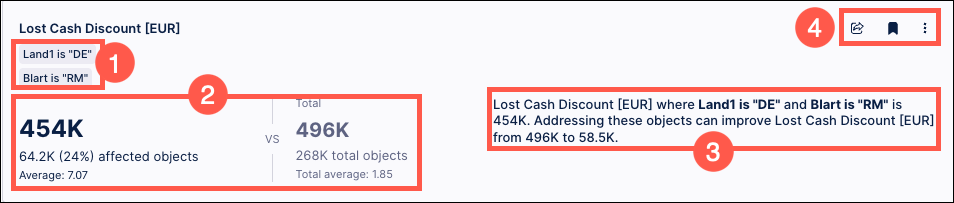

Screenshot showing an example of an insight and they types of information shown in each insight.
  1. The filter applied to this insight to indicate which subgroup(s) is performing poorly.
  2. Quantifies this insight as a comparison between a subgroup and the overall population.
  3. An explanation of the insight.
  4. Categorize the insight:
    • Export this insight as a Studio View.
    • Click the bookmark icon to add this insight to the Bookmarked tab to be able to return to it later.
    • Copy the filter as a PQL statement.

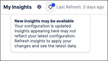

Insights are not refreshed automatically when changes are made to the underlying Data Model or Knowledge Model. If these changes happen, you will see a warning icon on the Last run button in the toolbar that new insights may be available. Click the Run Analysis button to re-run the analysis in order to avoid inconsistencies between insights within Insight Explorer or between Insight Explorer and other assets connected to the same Knowledge Model.
Screenshot showing the refresh insights button with a warning that new insights may be available.

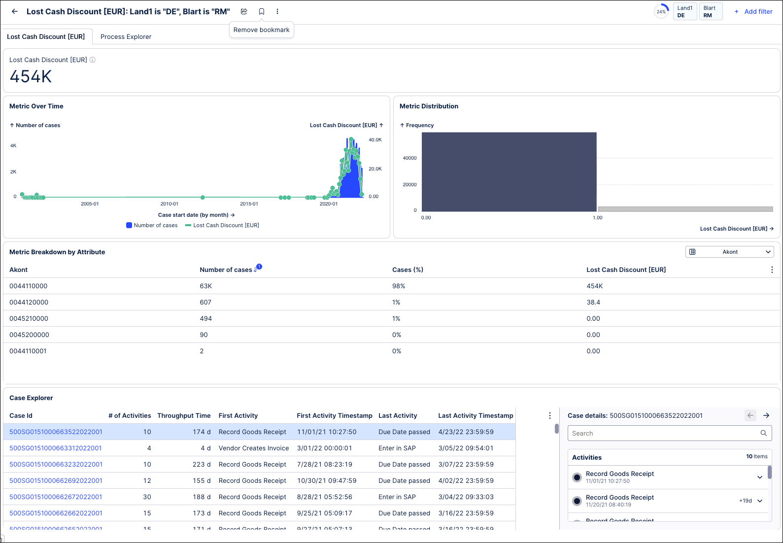

Click any insight to access the Insight Details page, where you can do follow-up analysis using the provided tables and visualizations.
Screenshot showing the data associated with an insight in graph and table form.
The View section of the details page contains:
  1. View
    • Metric evolution over time, metric distribution, metric breakdown by various attributes
    • Case Explorer for a granular look at the specific objects affected
    • Process Explorer
  2. Filters
    • The View is filtered on the insight by default.
The header section of the details page contains:
  • The insight you are currently investigating. When you apply or remove a filter in the View section, the scope and potential improvement of your insight is recomputed to reflect the filter changes.
  • Save filter changes: Save your filter changes to the insight so that the updates are persisted from the details page to the main page.
  • Export to View: Export the insight details to a new View in the package to make customizations or configure Actions.
