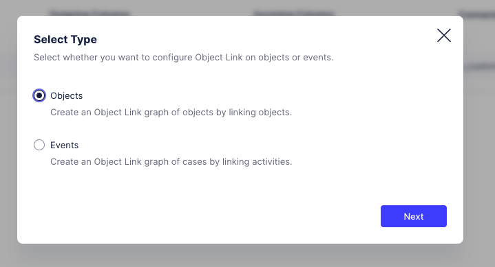

  1. Navigate to the “Object Links” tab in the Data Models section of Data Integration, and create a “New Object Link.”

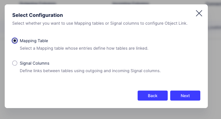

  2. Select type “Objects” and “Mapping Table” configuration

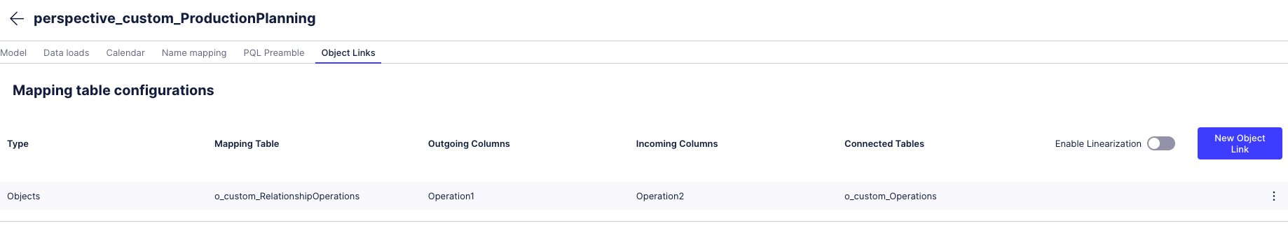

  3. Select “o_custom_RelationshipOperations” as your mapping table, with Operation1 and Operation2 as your incoming and outgoing columns, respectively.
  4. Select “o_custom_Operations” as the “Connected Table” with column “ID,” and save your configuration. You can now load the Data Model.
